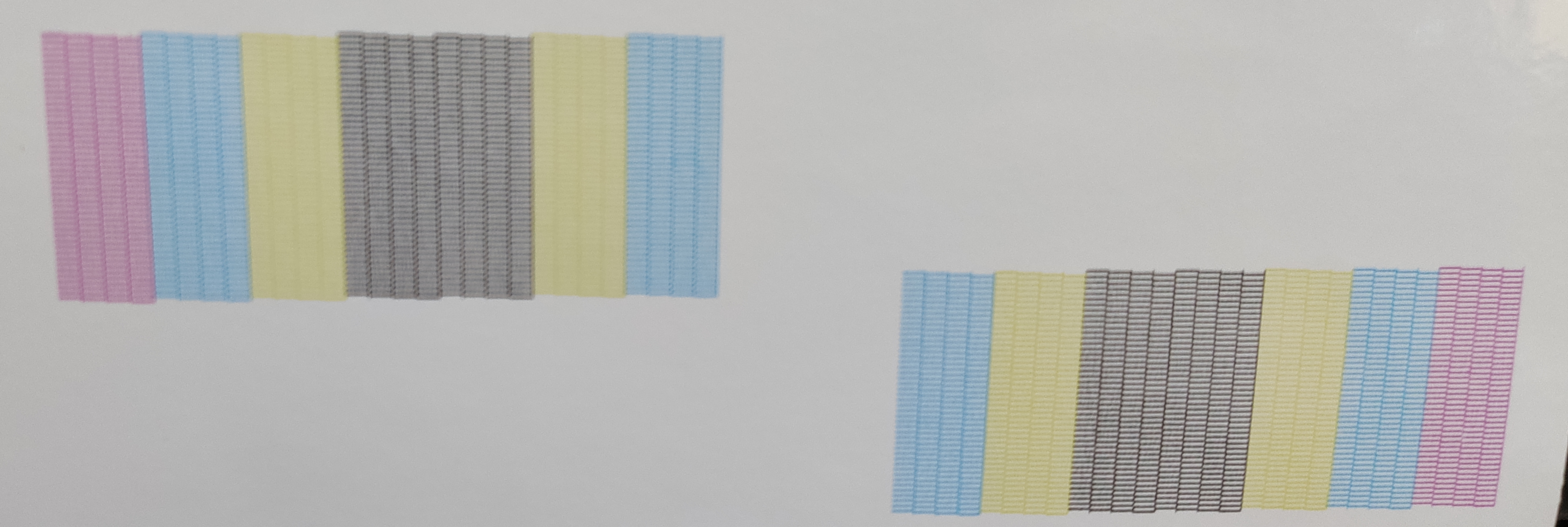

hello to anyone!
got a problem on one of my jv300 printer...
from on day to another missing inside channels of magenta of both printheads.
any ideas what could it be? caps, dampers, prinheads?
i will appreciate all suggestions.
thanks!
micadesign
Here a test print after head cleaning, nozzle wash and nothing changed.
jimmmi
What above said. Try to pull air from the magenta dampers with a syringe. Also check it cap top seals perfectly and also check the dampers if they are in good condition.

hey to everyone,
let me thanks four your replies.
unfortunately nothing of your ideas did help.
alos de left cyan channel form printhead #2 fails now...
electrical problem with both heads?
Solventinkjet
DIY Printer Fixing Guide
I'm talking about an official air purge procedure that gets the air out of the mid cartridge not just pulling air out with a syringe at the damper. You need to tilt the cartridge so that the septum is pointing up and then syringe the air out of it.
On that machine the ink lines are connected when you are setup CMYKx2. That's why if one head has an issue, the other can be affected as well. Probably not electrical. It's gonna be an ink flow issue.

air purge doesn't resolve my problem.
it's always an internal damage in the printhead. it sucks for me... now both printhead are gone. missing more colors now and nozzles are not clogged.
