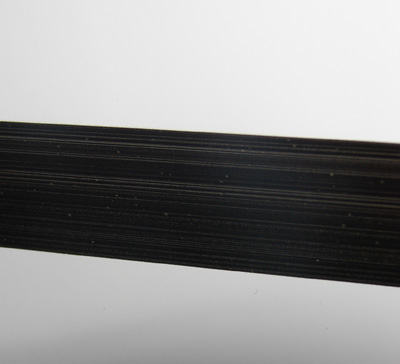

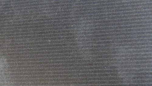

Hey guys
Recently I've noticed white strips (gaps) in the printed black..
only black areas look little striped.. as in the attachment photo
hard head cleaning didn't solve the problem, any other ideas??
Thanks!

Whats the test draw look like? Have to adjusted the feed compensation? Recently run the dot position correction?
Medo
I've adjusted the feed compensation, bud it didn't make any difference!
The problem solved by changing print head height :smile:
