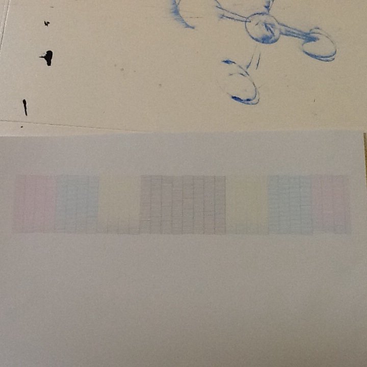

I have severe ink contamination on my mimaki jv33. Running triangle ecosolvent inks. All cartridges are 50 % or more full.
So far I have done the following:
new cap top
New pump (for mutoh falcon)
new dampers
Any suggestions as to what to check next?

Make sure the waste tubes are not submerged in the ink in the waste bottle. It can cause a siphon effect that can cause the contamination. Did the contamination come back right away after you changed those parts or did it take a while to come back?

I checked the tubes and they were not submerged. It was contaminated before changing all of the parts and after I changed everything. I just printed a 4'x8' and the nozzle check has the same contamination. All of the dampers are filled half way up the circle...would that cause the problem? What if I did a cartridge fill? I had entire bars of colors dropped before and it was fixed with a cartridge fill.

The circle part of the dampers should be half full. Running a simple cleaning cycle should get rid of the contamination. If it doesn't get any better after a cleaning usually it's a bad damper, cap top, or pump. Take a look at the bottom of the head. Does it look really dirty or have any ink where the nozzles are? I am thinking that maybe your wiper is dirty, or bloated so it is leaving ink on the bottom of the head. Also get a flash light and check that when the head is in the home position, the cap is lining up properly with the bottom of the head.

I think I might have a bad cap top or the head is going bad. I inspected it closely and it looks like the one corner might be slightly lower than the others. I just replaced it probably a month ago.

Maybe Capping Station Alignment
I was having black ink being drawn up into my yellow as well. My tech brought in a Mimaki supplied jig that lined up the capping station properly and the problem went away. He said it was from air entering the capping station because of misalignment. He also said you could line up the capping station manually by running a small bead of ink around the top of the capping station and then let the print head seat and then seeing that the ink lines left on the print head are properly positioned. Hope this helps.
