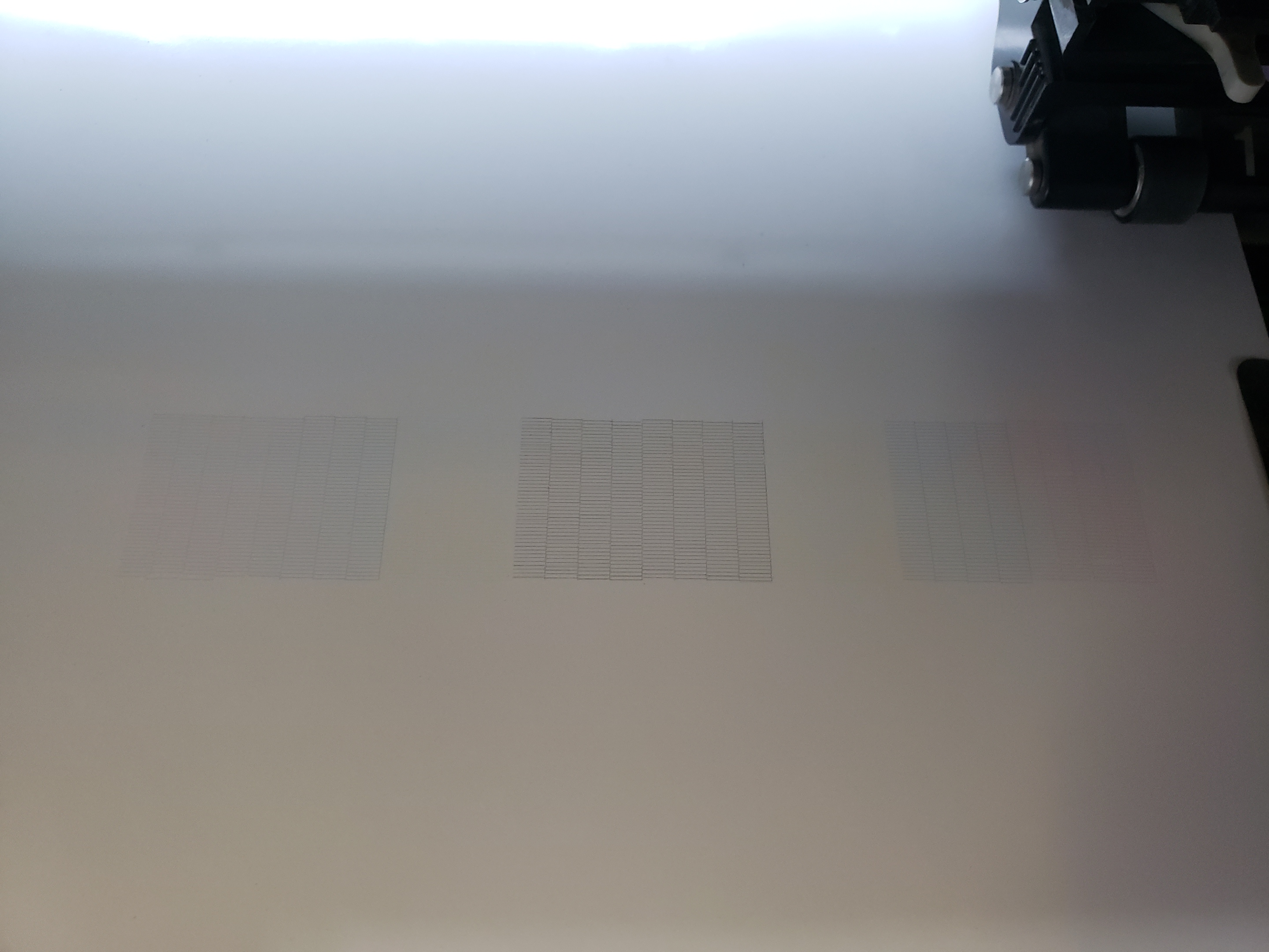

So I Just can't figure out why my mamaki CJV30 seems to be light on its prints. Yes it is looking a little bit grainy and have to keep the resolution and passes up so I get no bands.

Might be a different situation, but I was having a very similar issue. I found that I had a roll of vinyl that was shipped to me that was way past it's shelf life. All my trouble shooting was done with same roll so results never changed. Once I opened a new roll of media the print was correct.
