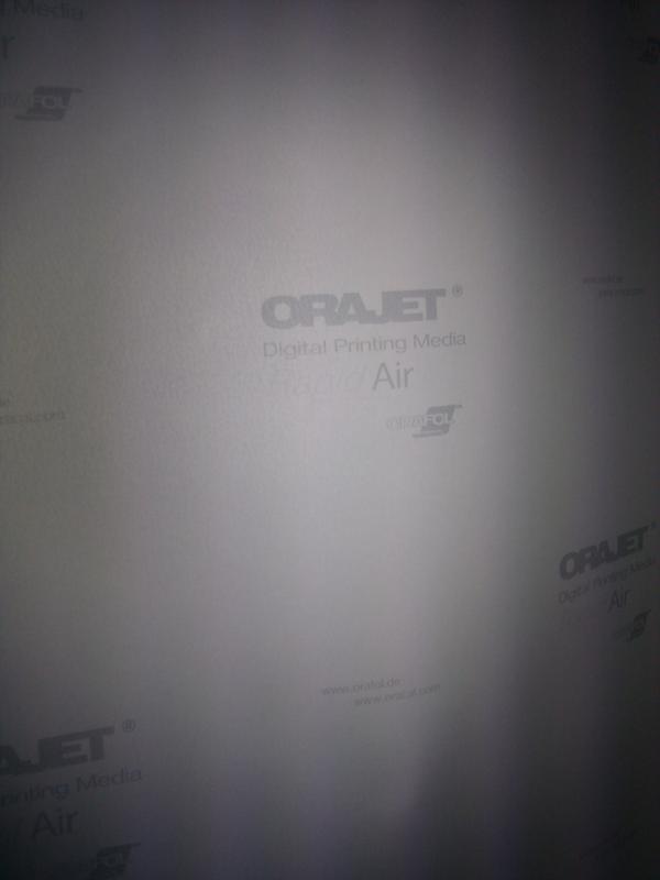

Hi,
RE: mimaki_jv33-160BS
To all the people of signs 101, thank you for giving so much for the help & assistance with us newbies. Much appreciated!
I have reviewed all the posts regarding this issue, tried the suggestions with no luck.
I tried a cheaper vinyl same results.
Am I missing something?
Thanks for your assistance :}

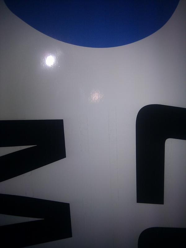

WB
I've had the exact same issues same printer. I believe cleaning all the rollers helped abit.
OSSrev1
WB, the rollers have no issue with printing stickers of a small nature ie 110mm h x 55mm w. I have printed 120 grouped with no problems at all. Same settings & conditions etc.:banghead:
WB
I know, been there. there has to be something on the rollers that is leaving a residue on the vinyl, or maybe they are taking off a coating on the Orcal.
We used to use alot of Oracal 3651, 3951. and had the same issues. Other vinyls would print fine. I could get 1/2 way through a job with the Oracal and suddenly get those lines from the pinch rollers.
Cleaning the rollers with alcohol helped abit but did not solve the problem. Using a Roland now and haven't had that issue.
