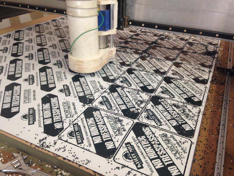

If you are looking for comerrtial print and contour cut solution it is more than 15K . AXYZ, Vision, Multicam has one. Adding crop mark recognition cost about $7k on top of the price of the cnc.
I do custom cut ACM with my cnc router. You just print crop marks and align cnc tool path to your print.
