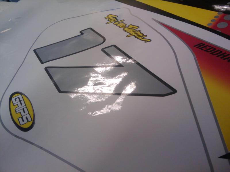

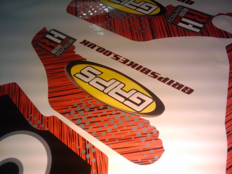

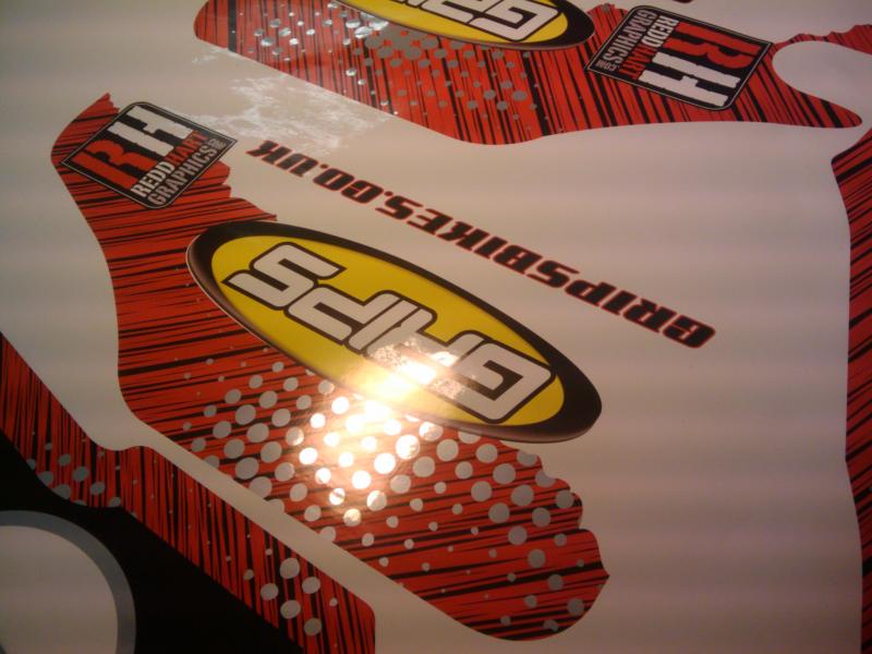

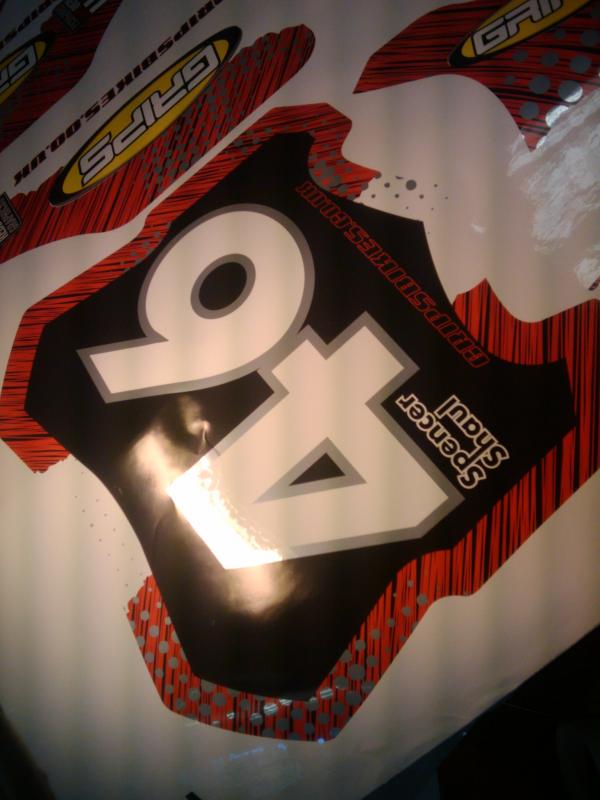

Hi waston, i was always wondering the same thing and still am! We have the new roland VS-640 and its a beauty!! we can now print chrome & loadsa other metallic colours which is awesome for MX applications & everything else too. I still want to now how people have/still are doing it? it must be screened?
Ive attached some pics of some kits we just printed with metallic, its rather hard to photograph & the camera on my fone is pants. enjoy. Steve

No its the new metallic ink roland have made, our machine is C-M-Y-K-Lc-Lm-MT-W
MT = metallic
W = White
so those silver bits were just pure metallic, pretty awesome!
