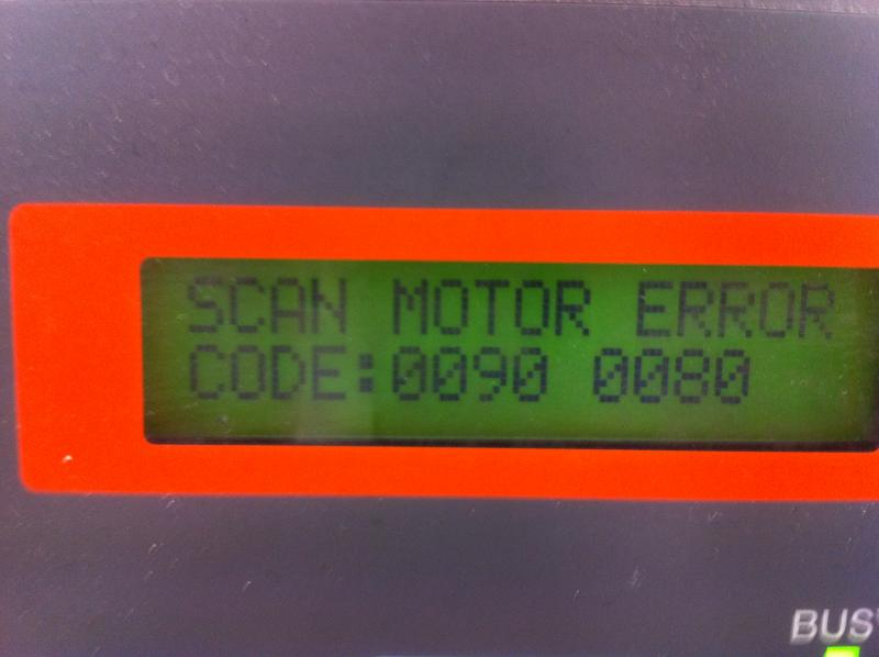

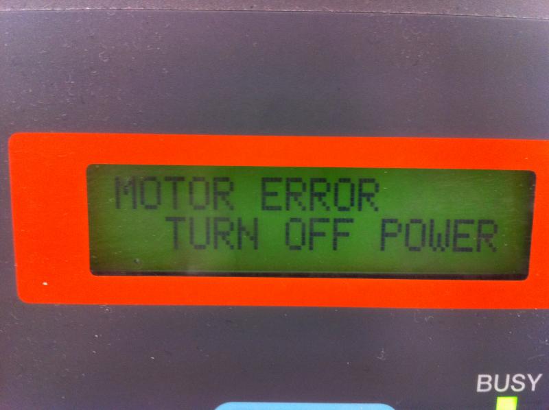

The story goes like this : I printed like 70 posters today and suddenly when i was doing something with my dtg machine i heard my sc540 wagon go noicy, Like something was stuck between the head wagon and the rails, Then after a few seconds i got the double beep and i got the error message on the screen of the machine.
i restarted the machine and it did a cleaning, and when i was setting up the paper i heard the hard noice again from the knife holder.. i started to print and after 3 times the head moved back and forward i got the same message again?

plz help i had to much trouble with this machine... :(

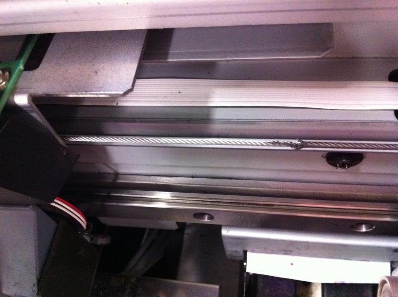

Then you may also want to check the Carriage wire pulley on the left side of the machine. The bearings inside the pulley can go out as well.
Do you see anything hanging from the cut head assembly? front or rear
Also check to see if the carriage wire is stripped of the plastic where the cut head assembly is connected to it...

And i got a picture here of the stript cable..
I dont think it is from the cut mechanism it sounds more coming from the tool assembly / rails..
