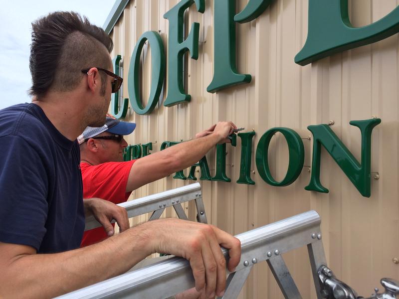

Just installed some with wire standoffs...standard item from Gemini attached picture shows how these work.
buy all the wires long enough to stand off the building...cut the ones that hit the ridges

What da Hell is on that guy's head ????? :ROFLMAO:

I will look into this method, it's been a while since I have installed any Gemini letters in anything other than brick to be quite honest.
