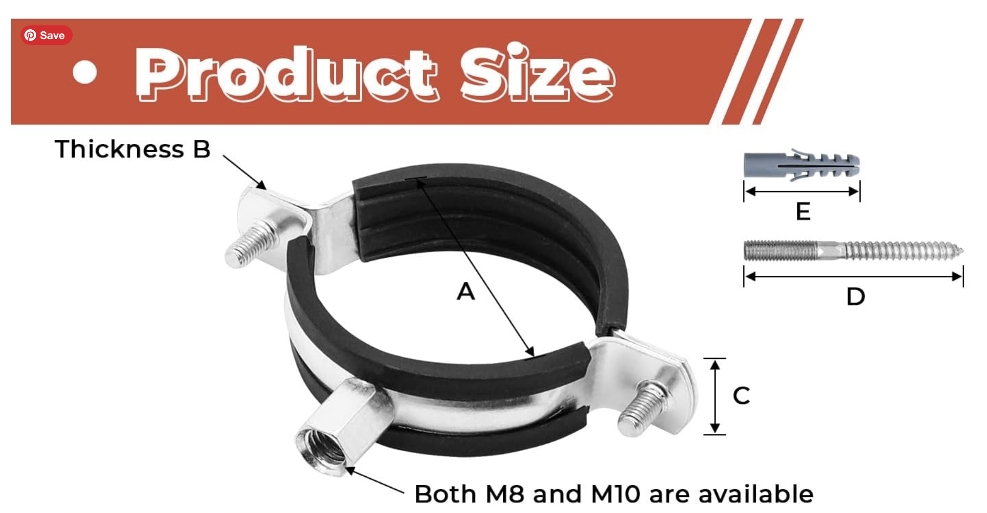

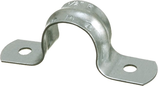

Yea Looks like conduit straps will be a good option for this. Thanks for the suggestion.
I also stumbled on these split ring mounts with threaded nuts while searching. I'll check out both of these and I'm sure one will work for what I need.

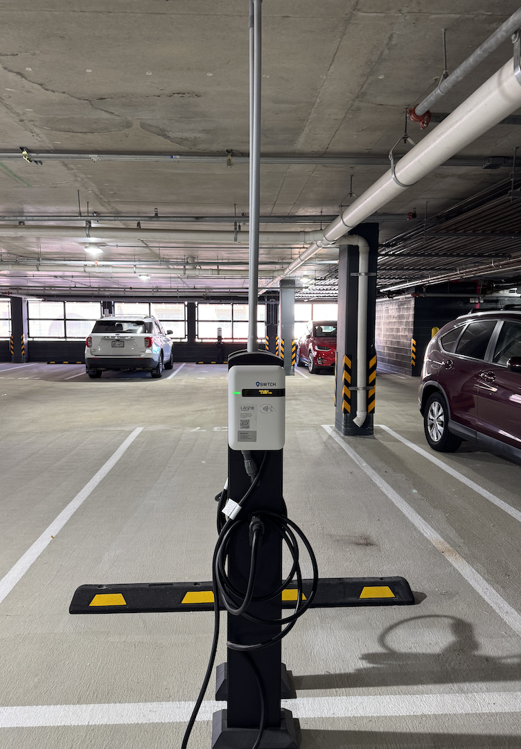

Hoping to clarify here. It's rigid conduit already existing inside a parking garage. The stations are installed centered in the parking spaces so instead of adding another post and base next to the station it would be much less crowded with a light aluminum EV parking sign right on the conduit.

Thank you Sean - that makes all the difference in the world to your question. You should have included the photo first.
My vote is "yes". just use the standard conduit clamps and call it a day. (you will have to drill the appropriate holes. I would wrap the area on the pipe under the clamp with black cloth friction tape to help hold it in place.
