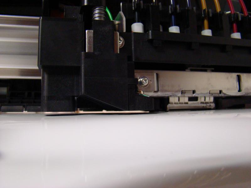

you should also get a video of the front while it passes so we can see what is hitting. It looks to me that the little locking pin that holds the carriage in place while not in use, is dragging on the print.

you should also get a video of the front while it passes so we can see what is hitting. It looks to me that the little locking pin that holds the print head in place while not in use, is dragging on the print.
I will have that uploaded in a few minutes. You hit it on the head no pun intended but thats what it appears to be. But why would it only do it in SL so heavily yet in Flexi it is pretty much non existent.

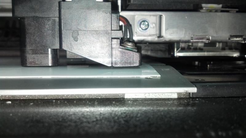

Here is a picture of the head moved out over the media. I feel this will show you a little better than a video.
Also is there an adjustment for it? :frustrated:

401Graphics
Yea that looks pretty close. I'll have to take a pic of my 1204 to compare. I dont know of any adjustment. Maybe something is wrong with the spring that holds it up?

@ Randya, thanks the first thing I did was set all the SL temps to match Flexi. After seeing 401's pictures you can plainly see my media sensor is too close.
@ 401, look at the difference in the height of our sensor compared to mine. Now the question is how to fix it. I am waiting on my email to the dealer as i sent the video to them so they can see the problem.

Ok the part that is causing the problem seen in the video I posted is called the Cutter Solenoid Assembly. It is obviously too low as seen in my pictures as opposed to "401's" pictures. Now I need to figure out how to adjust it. Waiting on the dealer I bought it from to email me back. I need to get this figured so I can get the work I have on hold done.
