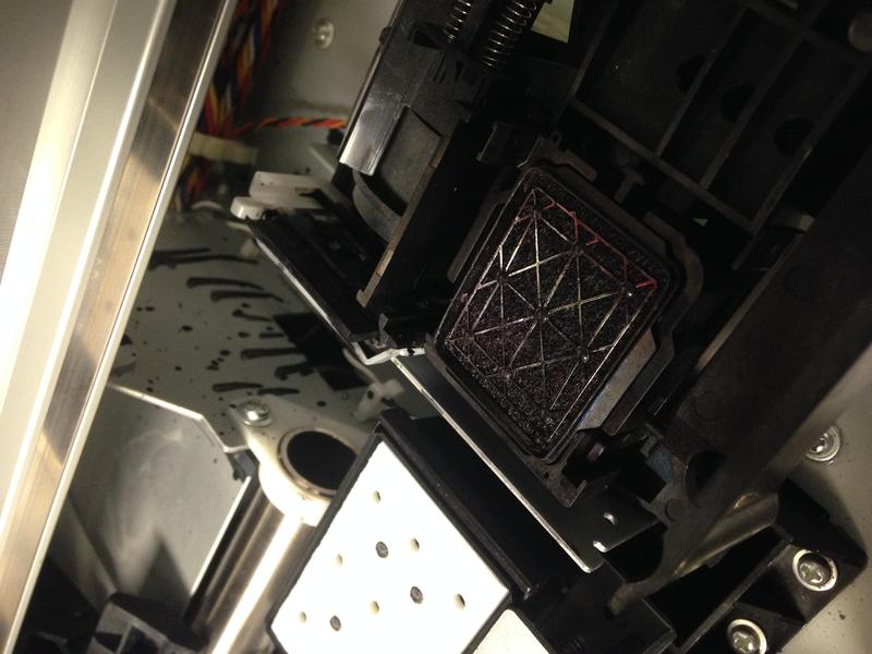

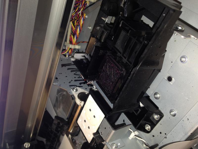

I put brand new endura ink cartridges and charged the ink, ran some cleanings, tried to clean up everything the best I could and tried soaking the printhead in solvent overnight on the capping station, but to no avail...

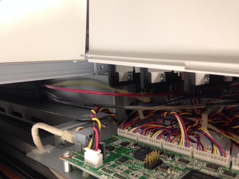

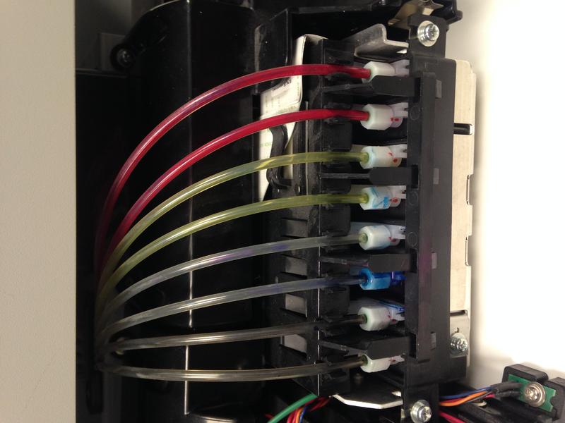

My guess is that some of the hoses might be clogged? Because I don't see any ink running through the damper cables, nor do I see any ink going to the waste tray.
I also purchased some cleaning cartridges. But when I inserted them into the slots a C/R err came up on the systems screen..
Ive hit a dead end and before I decide of replacing a bunch of parts in the unit with new ones, I figured to ask you guys!

The maintenance station (MS) is your biggest problem. If no ink is pumped through the MS during a cleaning, then you are dead in the water. Move the carriage to the left and remove the 2 screws that hold the cap top assembly in place. Use small fingers or a long pair of tweezers and remove the 2 black tubes that are under the cap top from the tubes that go into the top of the pump. Pinch off one of the pump tubes and use a syringe filled with cleaning fluid and try to push the fluid through the open pump tube. It probably won't go since it has been setting up for 7 months or more. You can try to use an empty syringe on the bottom (exit) pump tube and apply suction at the same time that you are pushing fluid in the top pump tube. If this fails, then you can try to push fluid from the bottom and suction it from the top. If successful, then do the same procedure to the other pump tube. These 2 tubes MUST be open for the MS to work. If successful, replace the 2 black tubes on the bottom of the cap top OR push fluid through them and make sure they are open. The 3rd tube under the cap top is for air only. Make sure that it is not clogged. Use cleaning fluid and clean the wiper. If you want to save time and trouble, then buy a new maintenance station. You can get one on eBay for $200 and have it in a week. Good luck.

I would change out the dampers and the cap top on the maintenance station right away. Initiate strong cleans for five times with cleaning solution. Then soak the head overnight with clamping the hoses so the actual cleaning solution stays on top of the cap top. If that does not work, I would change out the entire MS. If that does not work, buy a new print head for $2,800. Or buy a new 1624X for $14,000, limited time only. ** Perform jobs at your own risk.

I cleaned out the pump tubes as best I could. Ran a few strong cleanings. Ran a nozzle check, and still nothing. I should also mention during the cleaning cycle I did hear a "suction" noise, as if it was trying to pull ink through the pump? My guess is that the pump assembly is completely dried up. Rather than disassembling the pump and trying to clean inside of it would buying and replacing the MS be a better option? I tried to clean around the MS best I could but the dried ink is really on there.
