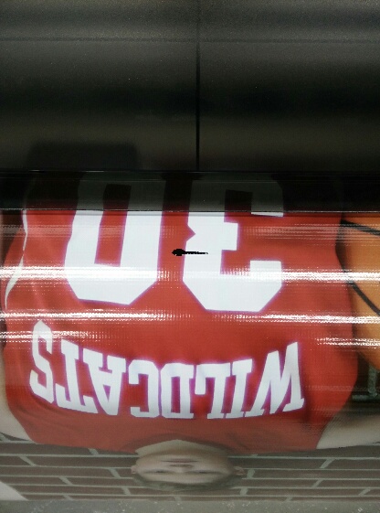

ok so today I have 20 banners and a wrap to start printing. While printing the first couple banners my Mutoh starts laying down a random .25x2" blotch of ink in the middle of the design. Any ideas on what is causing this and how to get it to stop?
Thanks!

Check underneath the print head and clean around the outside edges. Ink builds up over time and creates inkcicles that will end up dropping ink once enough builds up. Also, make sure your wiper is in the back position when the printer is printing. If it is stuck in the front position, the head will wipe across every time it moves back and forth which will build up ink to drop on the print as well.
If everything is clean and working properly I would change the dampers. A bad damper can sometimes cause too much ink to fall out while printing.
Do 2-5 times cleaning than you get a good result.

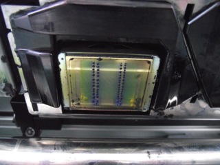

This is how our printhead looks after printing- it is clean at start...

There are two heads- the other is fine and they share the same wiper- any other ideas or do you think the wiper may still be the cause?
Many Thanks.
Many Thanks.
There are two heads?
As I know, Mutoh VJ1304 only have one print head.
I will email one of my friend contact to you, he know Mutoh printers well.
You can contact them for more technical advice.
