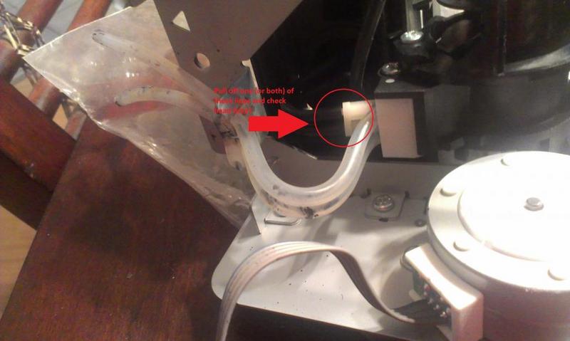

Is this the line to try to pull ink through?:
The capping station is as dry as a powder house so I would be shocked if anything comes out. The previous capping station was dry also when I replaced the maintenance station.

Solventinkjet
DIY Printer Fixing Guide
It looks like ink had never made it through the new maintenance station after you installed it. The first thing you want to do is take the head cover off and check to see if there is ink in the ink lines and dampers.
If they are empty, either the maintenance station is not sealing with the head properly, the head is not new and completely clogged or the machine was completely empty before you changed the maintenance station and you didn't run the ink fill up procedure/the pump hasn't run enough cycles to pull ink from the cartridge to the head. Check the ink lines all the way through the machine. If they are mostly empty, you probably just need to run the fill up cycle. (Note: If the fill up cycle doesn't move the ink at all, read below)
If there is ink in the ink lines and dampers or the ink doesn't move when you run a fill up cycle, the head is completely clogged or the maintenance station is not sealing up with the head properly.
In either case I would hook up a syringe to the waste ink lines. (Note: You either have to use 2 syringes, 1 per waste tube, or use 1 syringe and plug the second tube for this to work or else you will just pull air no matter what.)
With the head capped, pull the syringe plunger down. You should feel resistance and if you let go of the syringe plunger, it should snap back. If you feel that you are getting good suction, hold the plunger down until you see ink flow into the syringe.
If you pull the syringe and then let it go but it doesn't snap back and/or you hear a hissing sound coming from the head area, you have air getting into the system. Usually the air is coming from a bad seal between the head and the cap top. Try wetting the cap top down with cleaning solution to get a good initial seal and try again.
If you pull the syringe and get a lot of resistance and it snaps back when you let it go but no ink comes into the syringe when you hold it for a while, your head is completely clogged and you may be able to recover it but it is unlikely.

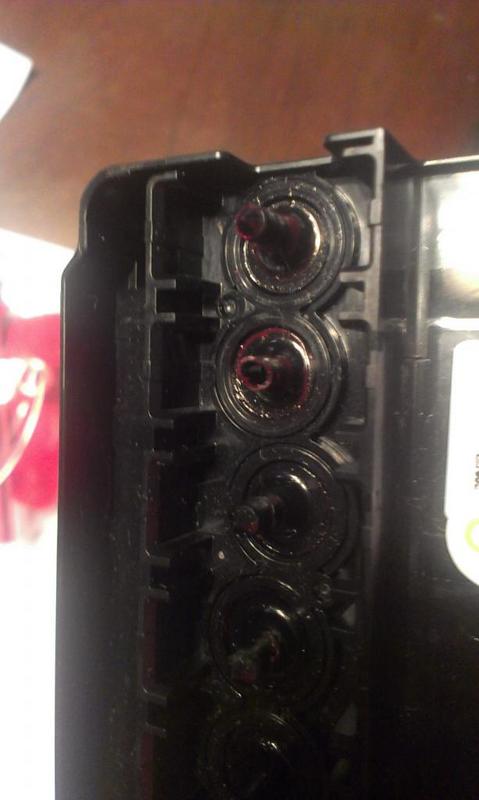

Thanks VanderJ. I decided to try to see if the dampers have ink. There weren't any covers on the head (probably not a good sign) so it was a quick process. The dampers all had ink in them:
I thought this was a very good sign. As I was putting the dampers back on, one of the magenta dampers didn't seem to want to seat. I took the dampers out again and one of the magenta nipples on the manifold appears to be totally eaten away:
So I obviously I need a new manifold. Is there a way to check the head while it is out? Or, should I assume it is okay? If I assume it is okay, how can I keep it from drying out as I await a new manifold?

Solventinkjet
Just keep the head capped while you wait. You can still try to pull ink down through the maintenance station to test it but you may want to wait until the manifold comes in.
Also, check that the print head is parallel with the platen. It is common to see the head slanted, when someone who isn't familiar with working on the machine, installs the head and does not get the head pushed all the way down into the proper position which would make it so that the head doesn't touch the cap top properly.
PS. I forgot on the 1304 there is no main head cover. Just the damper holder that holds the dampers down. You should be good in the regard.

I think you have found the problem and I would agree with vanders comments about the head not being pushed down properly.
As the main issue with the cleaning system is that it has a good seal.
Looking at the way this head has been installed and the damaged manifold I would question the maintenance of this machine.

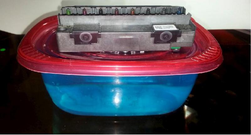

if not sit it on a millimeter of solvent cleaner for half an hour any try again
then do the simply test to see if you have maybe fixed the seal from head to head capping
i.e. you may put it all back together and it may start sucking
i'd put a little solvent cleaner into the dampers
you may have a bad seal, and a dried out clogged head - from sitting idle.
when you place the head down on a solvent soaked j-cloth, at least you can guage if any ink has reached the nozzles

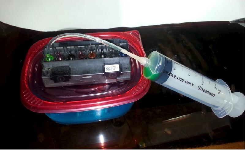

I can pull air through the manifold/head (I make it look clumsy but it wasn't hard to pull air through):
[video=vimeo;115736303]http://vimeo.com/115736303[/video]
It would be great if it is just the head wasn't seated correctly (and needing a new manifold).
thesignworks
hello

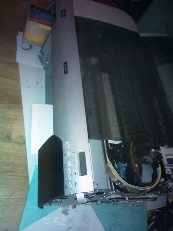

at the rate of which you can pull air through that head with a 10ml syringe 'to me' denotes a new head totally clear, thats good news in so much as there is nothing in it, so wait for the new manifold ...20 days!!
IF you put it all back together how on earth will you be able to stop yourself wanting to check the cap seal, then filling it with ink
just to clarify - you have a new captop
If you have refillable carts, you have the air bleed holes open.
also, I feel your pain with regards the 1/2 millimeter your head cap was off not sealing, as I am in the exact same predicament as yourself.
though my cap was sealing, the head was good 'bar the cyan' on running it with water based ink I left it out for 10 days and it clogged up, after fitting a solvent manifold, solvent dampers, solvent o-rings and metal nuts and a solvent wiper, then filling it with solvent ink, the head was starting to come back, then the seal was lost after I wiped it over with solvent cleaner 'I think' I did buy a solvent head cap, but the wrong one..........
I also looks like the waste lines on the value jets is the same stuff as the stock epson stuff, so it must be solvent proof and I needn't have had the pump apart.
waiting on parts sucks
If it were me and it were new years day, i'd run that manifold 'if it sealed',
its always the cap top, and its tough as because you cannot see it, you presume its sealing, the only way to tell is by pulling on the waste lines- but as you have had the head off and its clear, it 'should have worked'
oh and lastly, is the broken bit of manifold still in the magenta damper asyou might bust the new manifold forcing it on

I was pretty excited when I was able to pull air through the head so well. Maybe the previous owner was telling the truth about it being a brand new head that he could never get ink through. Even if it is not brand new, I suspect it is almost brand new.
I think I'm going to wait for the new manifold before trying it again. When I tried to pull through the broken nipple, it wouldn't seal. When I looked at the bottom of the damper, the O ring is turned sideways. I have a couple of new dampers that I will put in it. As I think I mentioned, when I pulled the head out it was slightly askew. I suspect what the previous owner thought was a bad maintenance station was actually the head not sealing against the cap (fingers crossed). The maintenance station I have I purchased from Rat Fink on here and he said he only had it in for half a day (the cap is still showing some white). Even then, I have a brand new cap if needed.

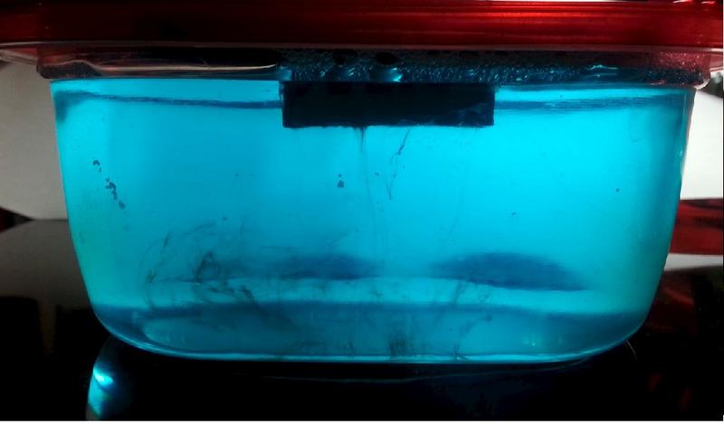

Should I try to pull some cleaner through the head just in case there is some ink in the head? I'm more familiar with the DTG printer world and every once in a while you have to try and reclaim the heads. When we do try to reclaim them, we use a homemade container (DO NOT TRY THIS WITHOUT ADDITIONAL INSTRUCTIONS AS IT CAN FRY THE HEAD) like this:
We use a mixture of Original Windex cut 50/50 with distilled water (that's what is in the above container). You can also use A solution made from 80% distilled water, 10% Ethylene Glycol, 10% Propylene Glycol, by weight. Do you use a manufactured cleaning solution?
