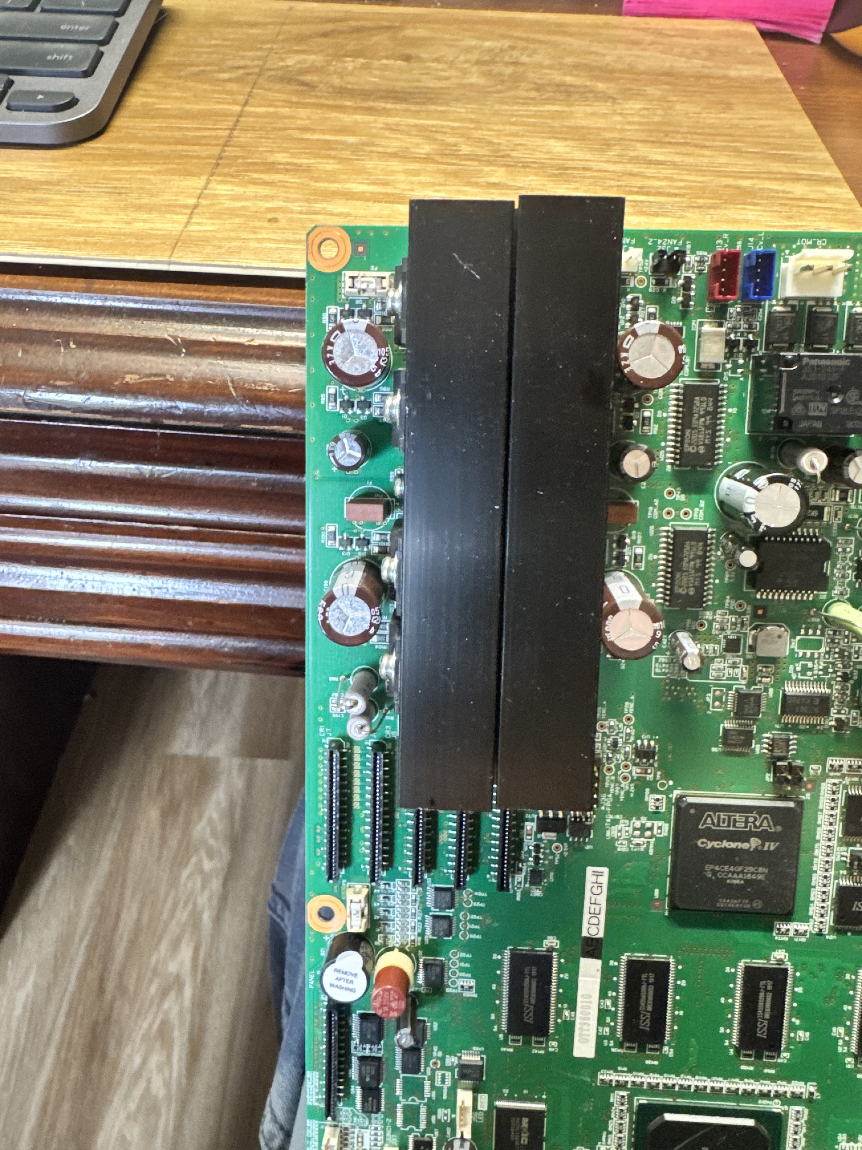

So, 2 weeks ago, my printer randomly wouldn't print certain colors on a nozzle check so I was advised to change my dampers and cap top. Dampers came first and I changed those, ran a text print. Printer was printing, just not the right colors still. Took over a week to get the cap top in, changed that and now the printer is not printing at all. I am able to pull ink through manually when the head is parked over the capping station, but nothing happens when I try to print. I've tried everything and I don't know what else to do. Any help would be greatly appreciated.

Where are you located? This is an SR not an SR Pro? That fuse is very easy to install

Cool. Either put in a ticket at equipment. fellers.com or I can call you this evening. I’ll need your customer number or company name. DM it to me. Meanwhile order a head fuse from solventinkjet.com
