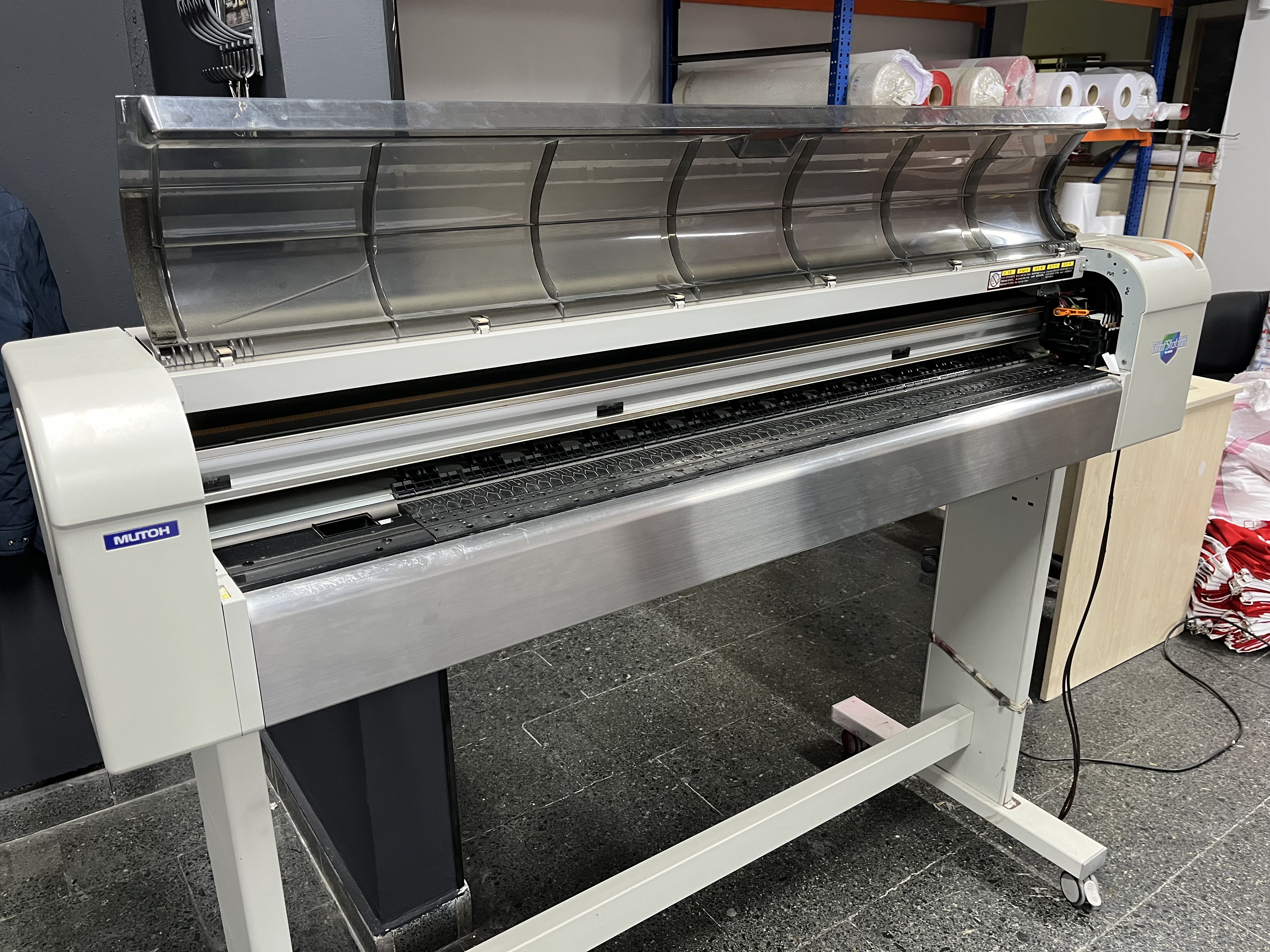

Hello, can I run the Mutoh RJ900C machine with Eco-solvent when the printhead and other parts are changed?
Martinnz.b
Technically yes. But you have to unlock printer for third party ink. Do you have correct profiles for it? Parts to replace. Ink tubes, capping station, dampers, and head.
GAC05
Quit buggin' me
You need to check if that printer has heater elements. I don't think it does (just one cord for main power). To get good results with eco-solvent, you need to pre-heat the material, have it stay warm under the print head, and post-heat to set the ink before rolling it up.
