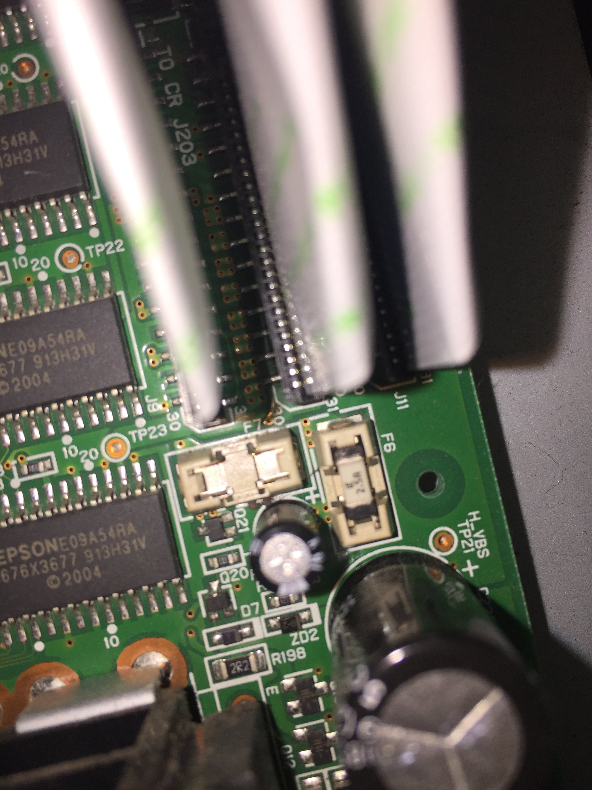

Iam having problems with printing with my Valuejet 1304:
First of all: the Yellow was not printing so i have changed the maintenance station.
Still it didn't work, so i continue further to take out the head and did a head soak.
From there the problem started, then no printing at all!
Only when i did a standard head clean i saw on cyan was on the spit box. and going through the pipes of the maintenance station
but no printing.
So i changed the head cables, the fuses (2 pcs) did a check on the fuses everything was correct and still no luck.
I ve read several threads that this might be a dying head, so I've got a new one.
Installed it with new cables, and still the problems are identical as with the old head.
Only cyan is going through the maintenance station tubes.
Is there someone who has or had this same issue?
Any help would be appreciated.
