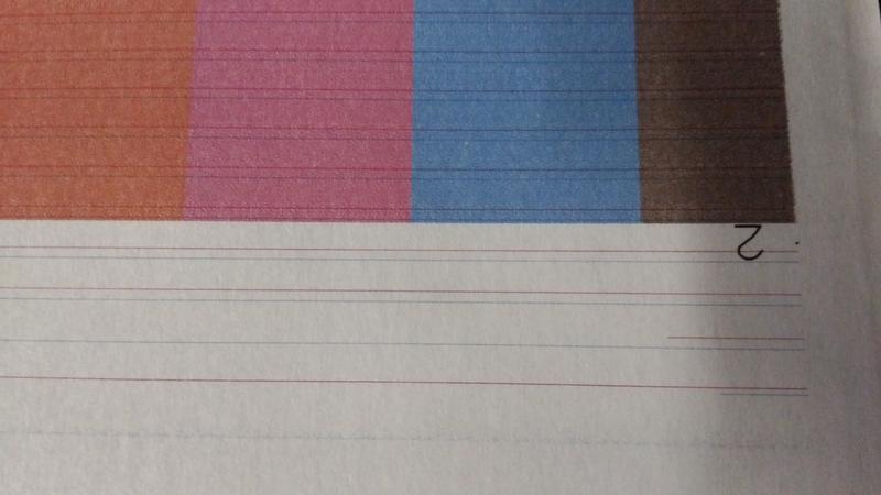

I have a Mutoh Value Jet 1628TD which has cyan and magenta faint lines running through prints...this includes test prints. See image attached. Since the printer is out of warranty, any help to pin point the problem will be greatly appreciated. There are no missing nozzles at all, only the two faint lines.
Thank you

When did the machine last have a print head and cable fitted?
That looks to me as if the head cable is failing or the print head is failing or maybe both.

Going to second heyskull. Seen this before several times and it has either been the CR or Head Cables. Probably wouldn't hurt to replace both.

However the lines are still there. Could it be the CR Cables??

Its hard for me to tell for sure from this picture but I have seen a bad ram chip on the mother board cause something similar.
