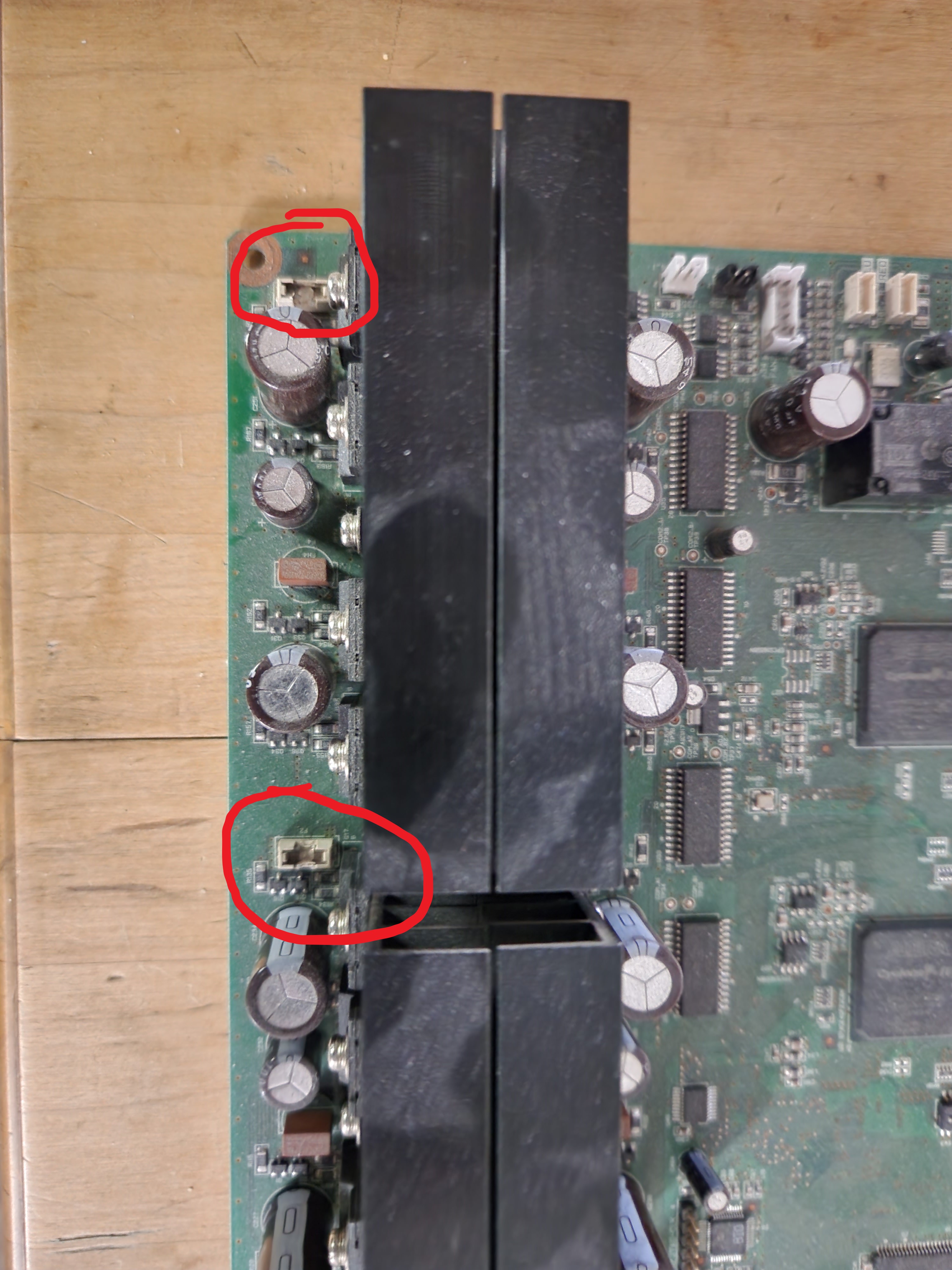

Change both printheads input new ID numbers, but only head # 1 prints when I perform a Nozzle check. I can see ink going through the lines when it cleans, but head # two just won't print. Any help PLEASE

You probably popped one of the head fuses on the main board. Double check your head cables to make sure they are plugged in nice and straight and aren't damaged or dirty. Then test the fuses on the main board. I've attached a picture where they are. They are 750mA fuses and user replaceable. 1638 fuses.jpg
