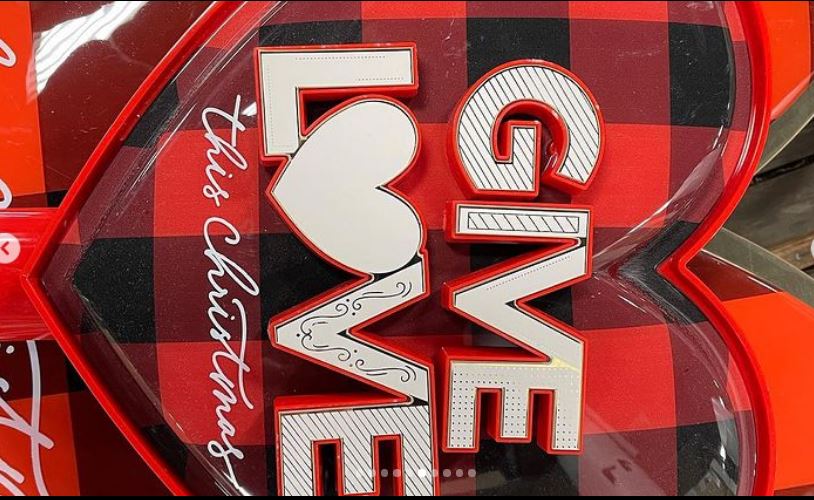

what do you need to print. we silk screen some jobs for bed, bath and beyond on plastic that is thermoformed after we print it
