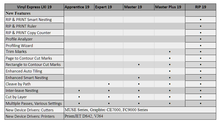

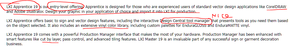

Which version of LXi? The cheapest is $199 the most expense version is $1,399

Since you are not printing you don't need the rip and print. If you do decide to get into printing decals down the road you can get your files set-up and then send them out to a place like FireSprint or Signs365 with a wholesale account. I think Apprentice would be sufficient. The contour cut is offered in the Master and used for print/cut however, you can create your own contour cut by using the outline tool if needed.
