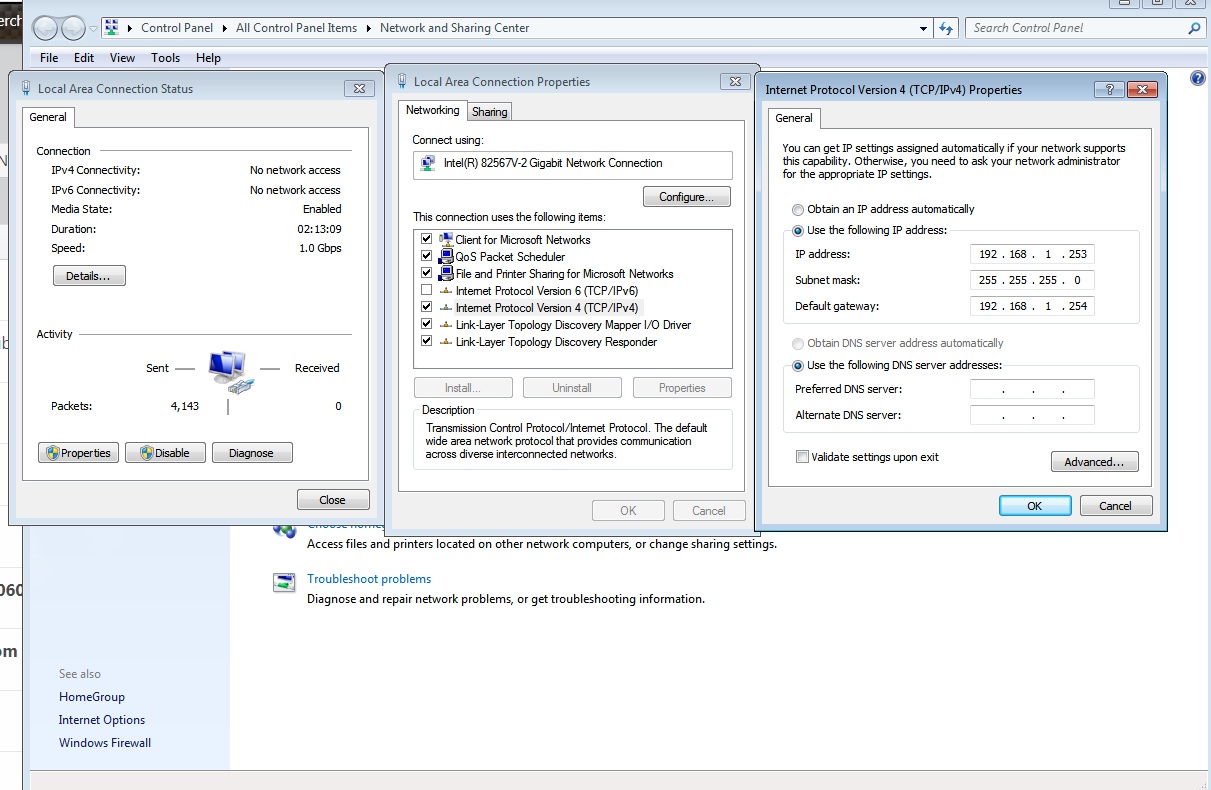

i recently restarted my computer and i forgot how to connect it the computer via the ethernet cable. everything i do its not showing up :(. can someone send me pics of how theirs is configured on their computer and on their production manager?
Mine looks like this on win7 running through a ethernet switch to the printer (no internet)
Printer is set from the key pad:
IP 192.168.001.252
Subnet 255.255.255.000
Gateway 192.168.001.254
The printer is the only device I have on this network
Should be similar on Win10
<had the wrong IP - was ....253 supposed to be ....252>
