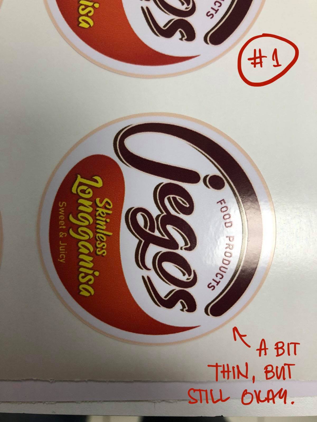

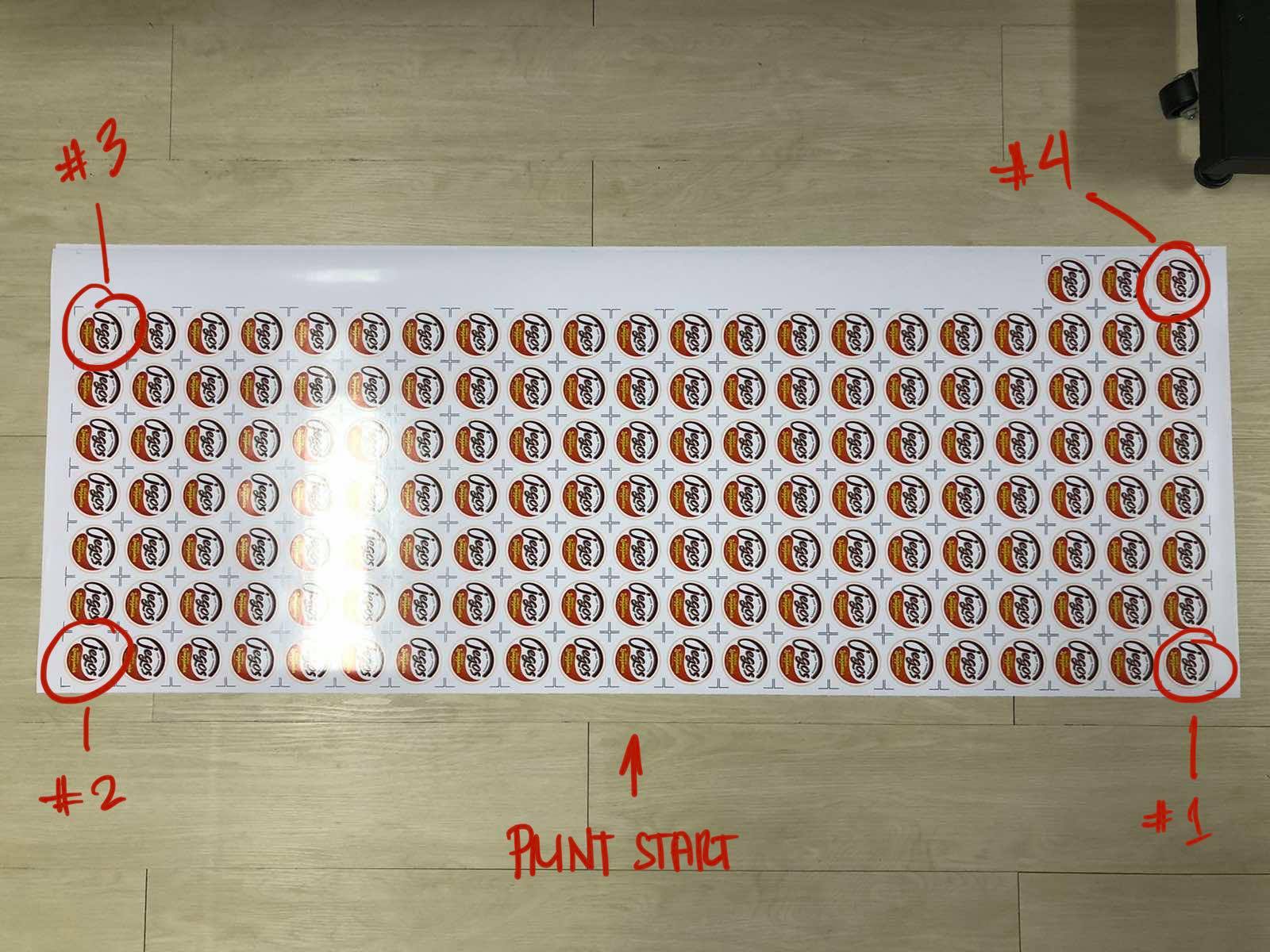

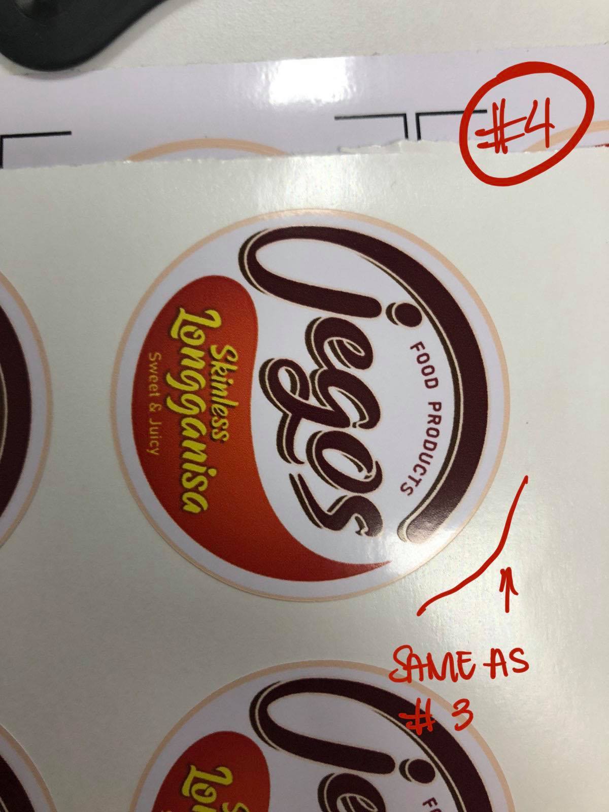

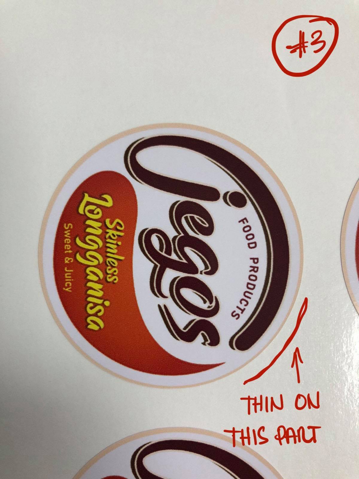

My apologies for my lack of information. I'll try my best to keep it detailed as much as I can. The example photos below are printed on an EJ-640, and cutting done on a GR-540.
1. I am using vinyl stickers as my media. Regardless if I am using Ritrama or some china branded media, the cuts are still off. For Ritrama, I am using an 80 GSM kind, and the China one is 120 GSM. All of my media is 55" in width and below.
2. I do the cutting in GR-540 by batch, meaning it's not loaded in the GR as rolled.
3. I am using Versaworks 6 as my RIP software. I also place the crop marks using versaworks as well.
4. Cut Contour lines are done thru adobe illustrator cc.
5. My prints are not laminated.
