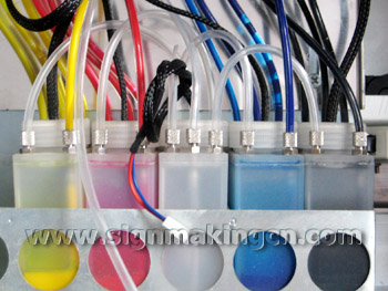

i need a help from you guys... so here is the question I have a 6Color 6feet Phaeton UD-213 Printer (4 Years Old) with SPT 255 35PL head and i'm currently using only 4 Heads... Because other 2 Heads have problem with nozzle(Nozzle Clogged and ink not firing directly)... currently i have a problem with my Magenta head the problem is if i need to print a 36'' X 12'' print with magenta it's getting clogged about half of the print so i need to clean the printer manually about 2 or 3 times to print depend on magenta That i have used on the design ... i checked adjusting head voltage but no luck... Tried with 6pass 4 pass 3pass same thing happend Test Print is 100% ok... what i have tried is cleaned the damper and print head with syringe as video shown(manually) and same result Damper works just like video shows so ... Do i need to replace the damper... I can provide actual images Or video if you guys need to check Kindly help me
