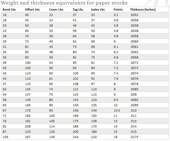

Just doing a quick check on the recommendations I can get here. I got some new customers that require printed posters on paper mostly 10pt, but I do get some request for some more heavy stuff like 18pt, 24pt and 38pt stock. I currently mount vinyl for those.
