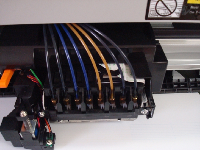

I'm trying to print brown and its printing green???? YIKES!!!
Whats wrong?
I did a cleaning and a nossel check all the heads are firing correct.
I did just notice this.
When I did the nossel check the magenta looks black???
I did just change this M cartridge.. what could have happen?
Ahh the attahment sould work this time.
jiarby
Take the magenta dampers out and use a syringe to pull clean ink through the line. New dampers are cheap.... just replace them.
If that does not fix it then you may have a bad print head. You may also have a bad maint station. Sponge swells, touches head, then contaminates other lines.
Thanks. I believe there was some cross comtamination when the old magenta ran out. I did a little charge and now am prinitg solid magenta and it is starting printing lighter. Hopefully it keep getting better. If not I will try your method
Stealth Ryder
This is most usually caused on a ValueJet by letting an Ink Cartride run completely run dry thus pulling ink back the wrong direction when the pump is in operation.
