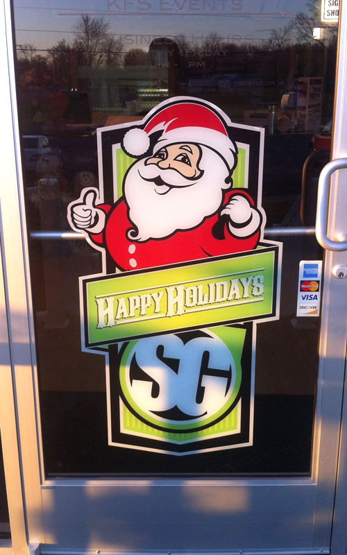

We have Roland's printable cling, but I don't really like it, so I printed in reverse on clear, then mounted it on clear cling. Next I used our translucent white (any clear adhesive white vinyl works) and mounted that on top of the reverse printed clear. It is mounted to the inside of the door.

Doesn't it wrinkle up after a few days? I did some experimental stuff with cling awhile back, and the ones with any kind of vinyl stuck on them wrinkled up. Like different expansion rates of the materials. Maybe indoors in a temp controlled environment it's not a problem?
