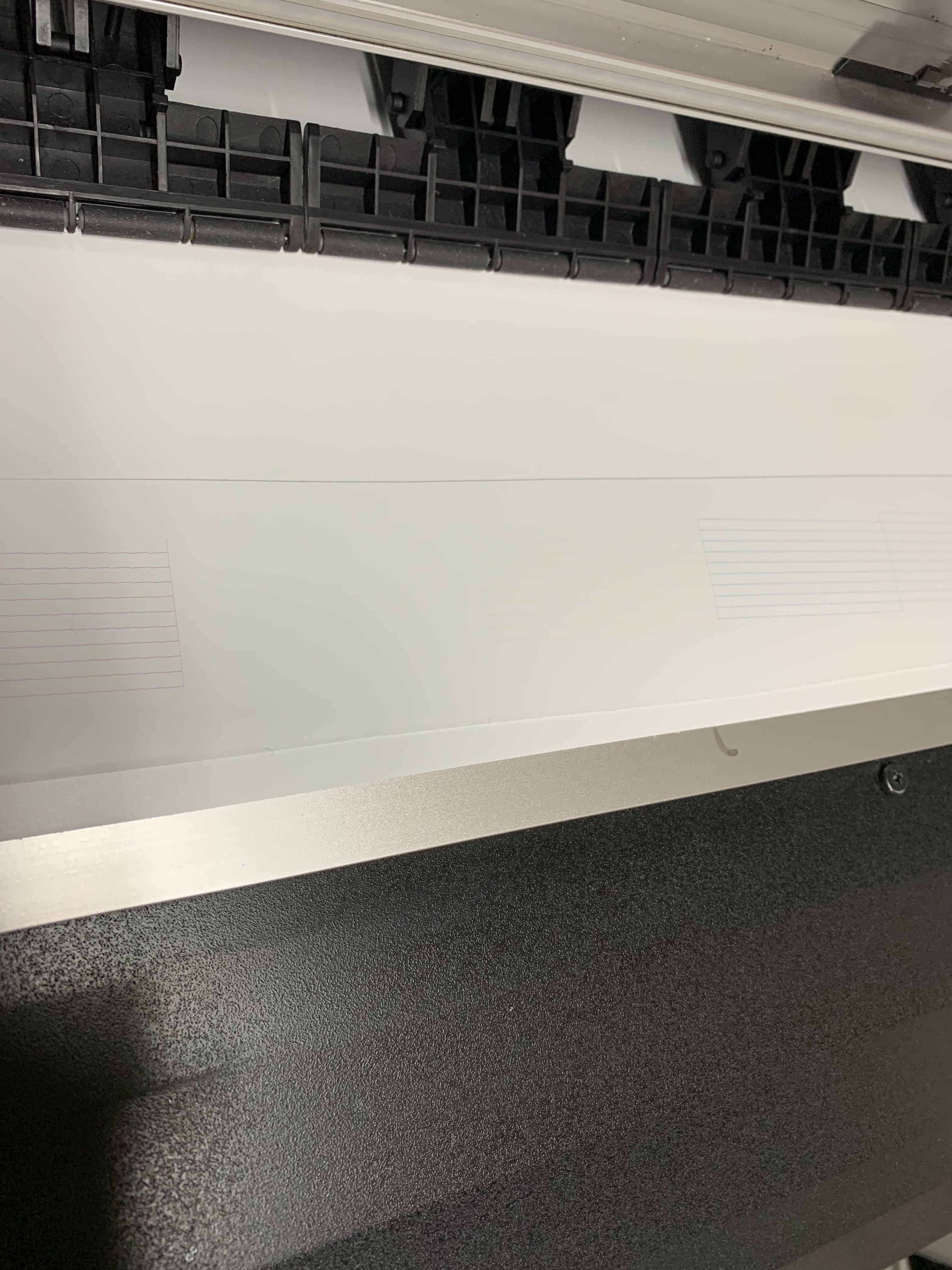

Nozzle check missing yellow
Netter26
I have a Mutoh 1324 and recently I’ve lost a whole yellow channel. Nozzle check is near perfect except for the one whole block of yellow on the left. The right block of yellow is perfect. I installed a new maintenance station in August. Any ideas? Thank you.
Solventinkjet
DIY Printer Fixing Guide
It's probably a failing damper. I'd change them out especially if they are over 1 - 2 years old. Each color on a ValueJet has 2 channels so if one damper is failing, the other one sort of over powers the other.
