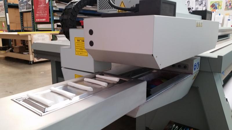

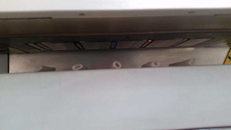

Just tried recovering some nozzles on my Oce 318GL using the 99% ISO. Was hoping that I would get better results as we're on the fence about replacing heads. Print quality only slightly noticeable on solid colors (banding/nozzle clog).
I cannot get the one black nozzle to come clean. The white however did clean up pretty well(minus the one nozzle that has always been absent), we usually clean the hell out out white before any white print goes through anyways. I will continue using the ISO esp. on white nozzle clean up.
First I went by the new procedure on swabbing and cleaning, didn't get much for a better result.
Second I "soaked" the heads in ISO (we usually would do this with Oce flush to the white head before white job) and did all 5 heads this way. (pictures below).
I did leave the "taps" turned to off position for the swabbing, turn taps back to on position, purge, then vacuum.
Hopefully continuing to use ISO I can eventually get black back 100% and delay head changing further.
