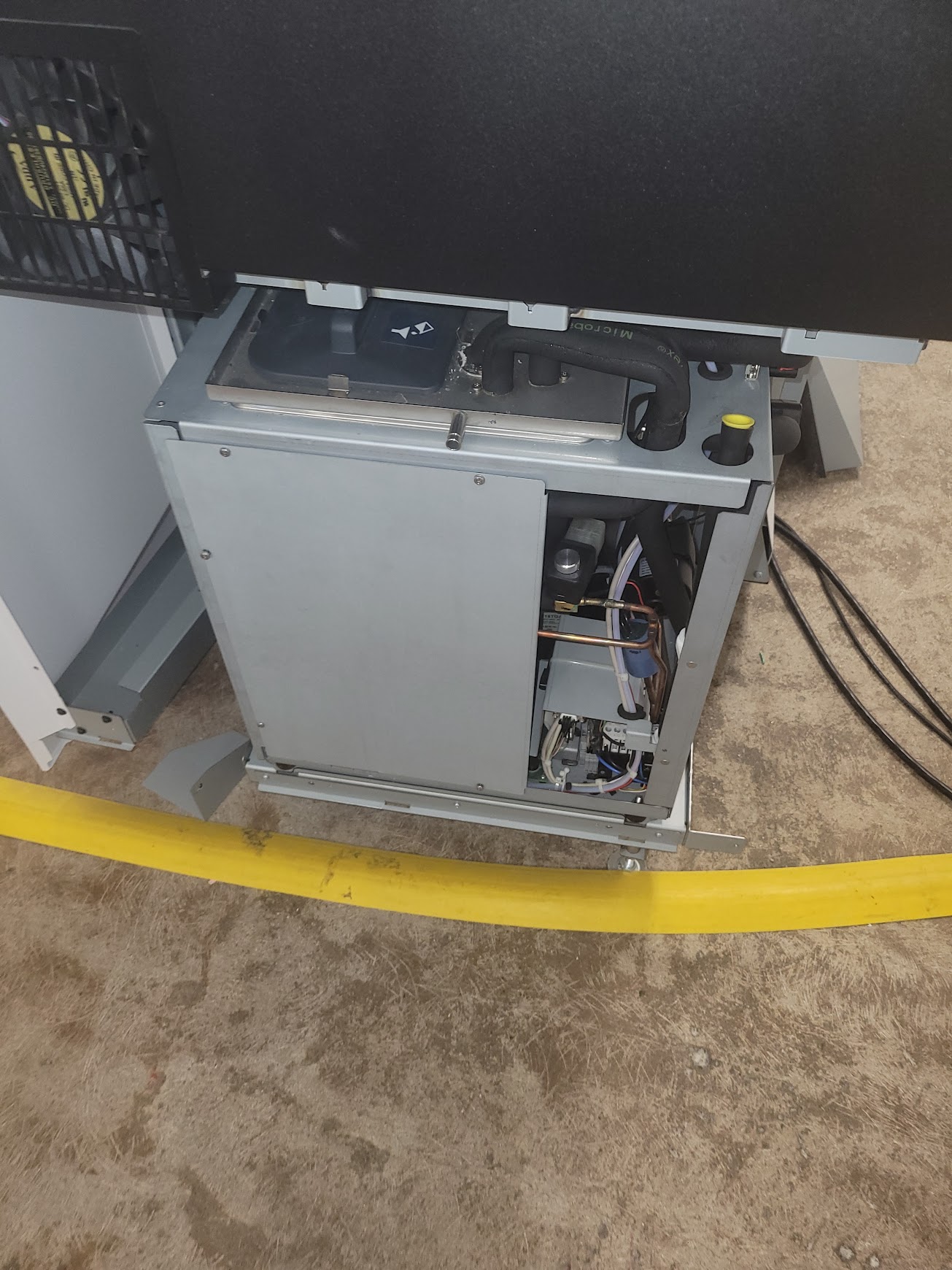

If you smell something burning and your printer is printing just fine without errors still go ahead and look at the chiller :big laugh:
My chiller had a little incident without any errors. Waiting for new chiller in 2 days hopefully
Took me 30 minutes to find source of smell, didn't think it was the printer because it was running perfectly fine.
