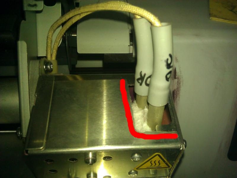

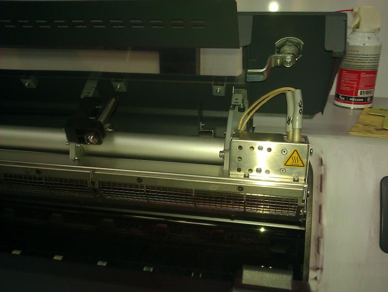

Anyway, I mentioned the issue to him and he told me how to fix it. I'll have to take a picture tomorrow to show, but basically on the right side of the heaters in the flip up window, there's a piece of aluminum that shorts on the element. Apparently this has been fixed in newer models. He took the piece off and I trimmed 1/4" off. Like some of you suggested, the theory was that banner held more heat and caused the element to warp just slightly and make contact with the aluminum, shorting the element.
We'll see if it fixed it....
Desert_Signs
Pics of the "culprit" after modification.
First pic just to give you a general idea of where it is (on the right of the flipped up window). Second pic shows the area where I trimmed off. The aluminum used to actually touch the element.
.... I did this and it still did not work.
