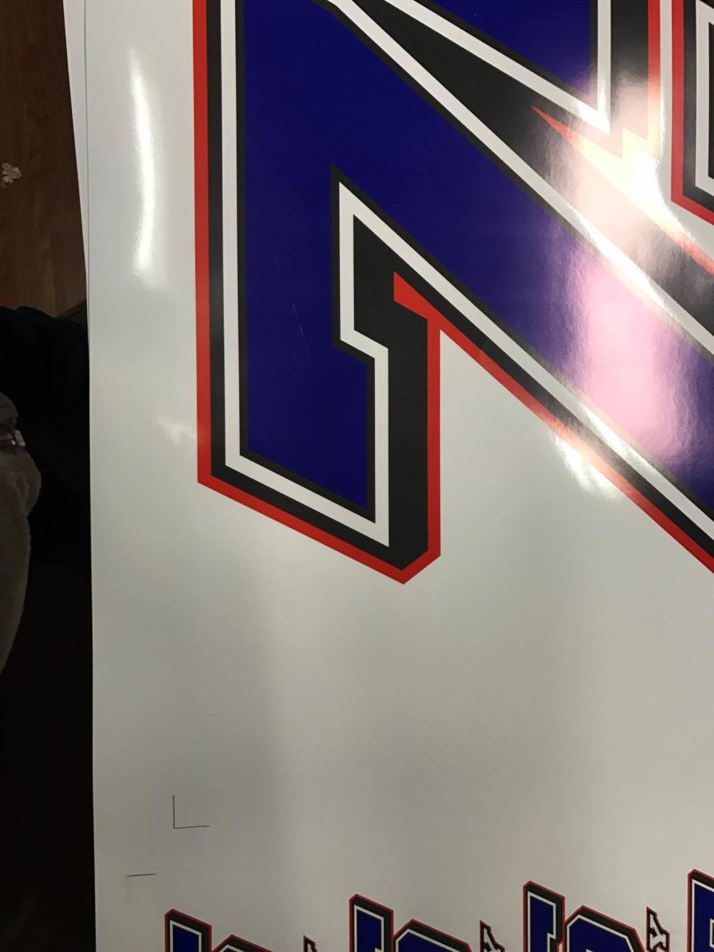

So I started printing some race car graphics Tuesday, I did installs yesterday, returned to my shop this afternoon to finish printing some sponsors, put in some new ink, and now my colors are WAY OFF. I double checked my profile, and every thing is the same! I am printing on a Mimaki JV3-160S using Flexi sign 8.1 pro and have never had this happend before! It only seems to be on this particular blue!

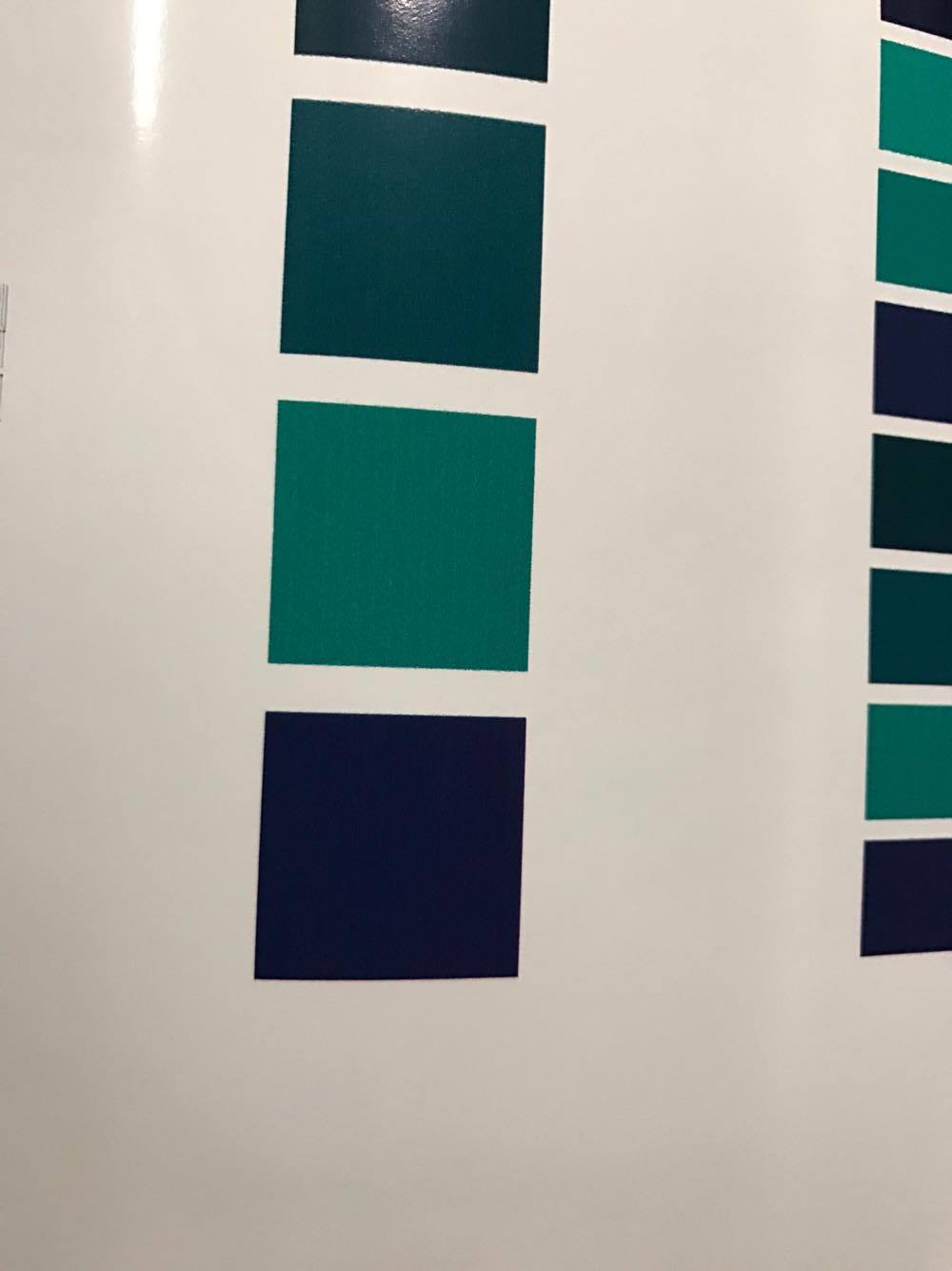

Knep
Another note, when I do a test draw the colors look right on that, when I print a 1inch block of cyan its more of a teal color...

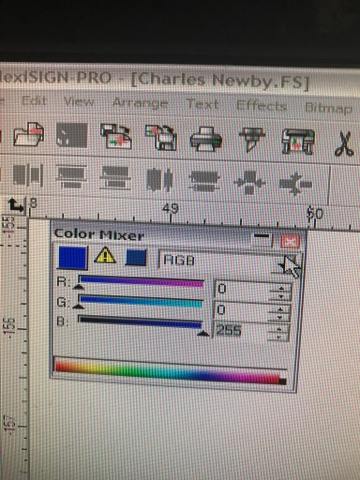

Knep
just noticed this warning on my color mixer, I think this is related to the problem, because its not there on my other pc...

Knep
It was something inside the flexi file. I created a new file and it printed fine with out that yellow warning sign on color mixer, not real sure still what exactly happened...
