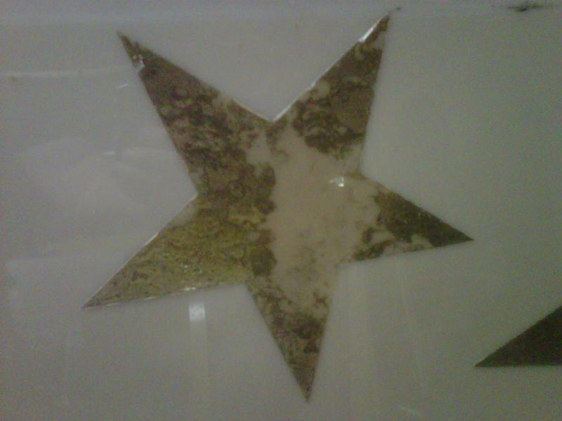

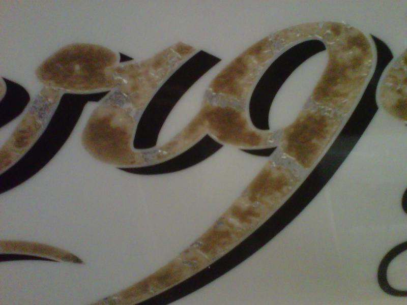

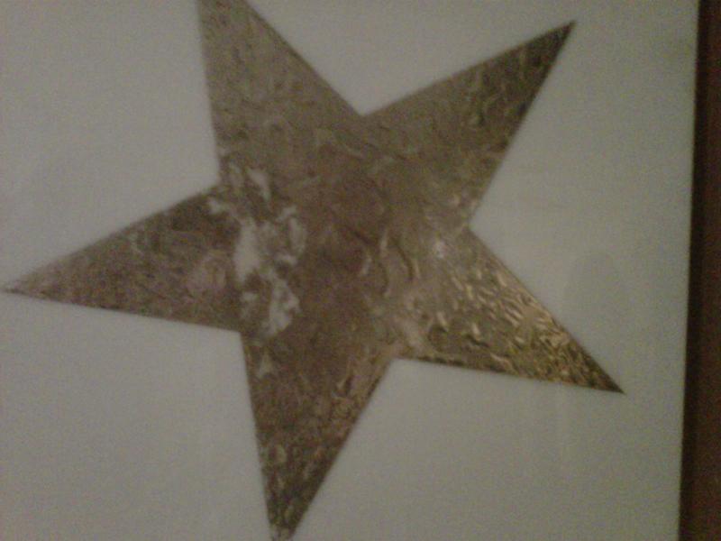

So after dealing with the flourescent pink lady and then dealing with the husband, I was doing a window sign when the lady from the business next door came out to talk to me. She wanted to get my opinion on her sign and why it looked so different than it did when it was installed.
This sign was only put up 7 months ago and the chrome vinyl is burnt. I have seen chrome do this before but it has taken a longer time than this. I am assuming it is a cheap chrome. I hate Chrome anyway so I told her we would change it to a metallic silver instead of chrome.
According to the lady I was talking to, the guy who did the sign originally can not be found and it started changing about 2 months after it was up.

elsignshop
i have seen a lot of chrome do that, i havent found a chrome yet that last more than a year or longer. i get alot of customers that want chrome but i tell them first up front before i cut anything, i say " it looks good but dont last more than 5 months outdoors" some people still pay for it but some just back off.
chopper
there are two or maybe more grades of chrome some are rated for 3-5 out doors and others are for inside use only,
I have some jobs that I have done that are about 5 years old and look almost as good as the day they were installed...

showcase 66
I am going to cut the acrylic just to keep the stars and some of the writing just to show people what it looks like after it has been in the sun for a while. It was on the south side of the building so it gets hit by the sun from sun up to sun down but still only 7 months.
