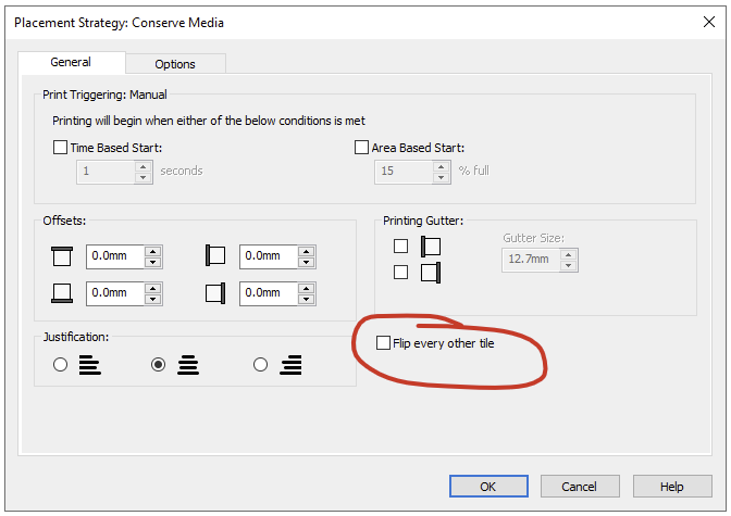

We never print anything tiled, but I noticed this setting... maybe it'll help?

If you send them as separate jobs you can't automatic flip them. That's how I think it goes even if you tick the flip box.

If you are sending each panel as separate file you can set up two hot folders, one for the right side up panels and one for the 180 rotate. I think the flip every other file only works if you are creating the panels in onyx.

The flipping every other tile only works if you send the entire graphic to Onyx and have it divide it up into tiles itself. You can control the width of the tiles and the amount of overlap.
If you're creating the tiles yourself, turn off "allow rotation" and then when you import the files, select 180 degrees rotation for every other tile.
