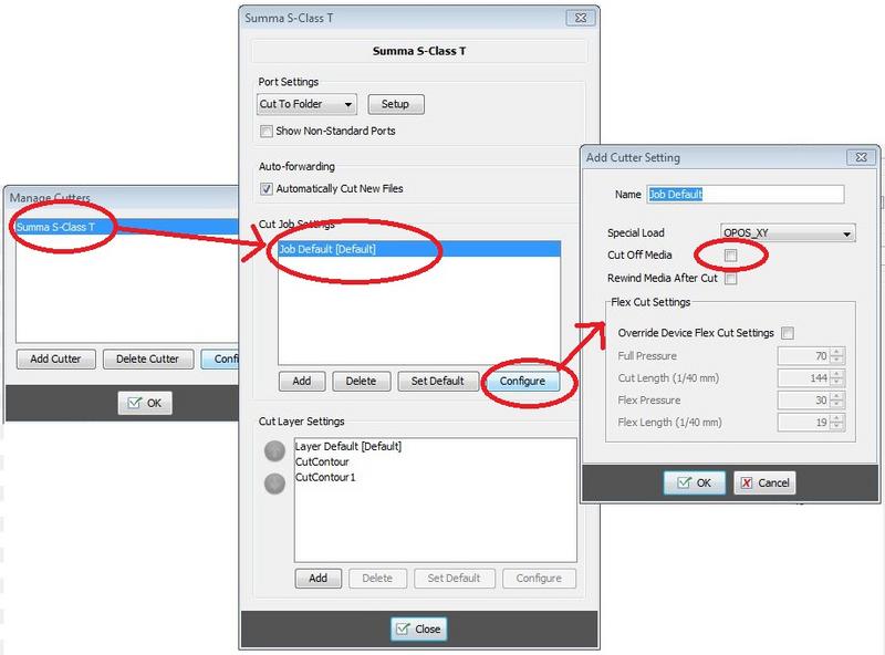

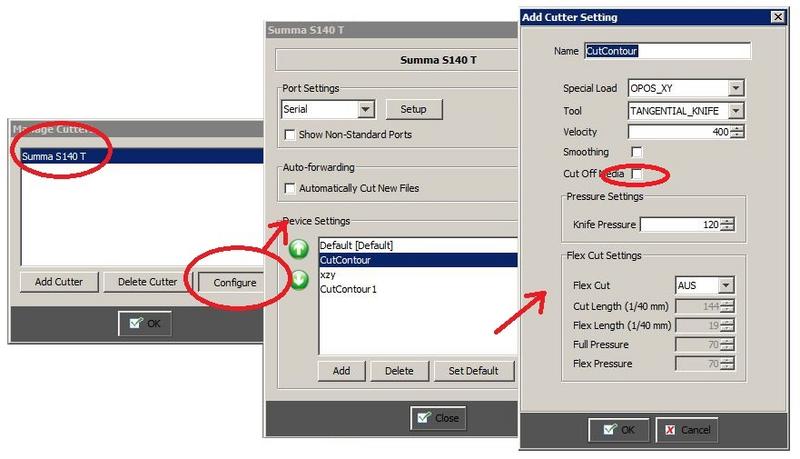

Of course they have it.
Attached please find two screendumps, one for Thrive 10.2, the other for Thrive 11.1. Be shure to set up a S-Class-driver, because a S-Class is the only summa cutter who have the automatic cutter.

Frank you are AWESOME!!!! I just tried it and everything worked! I am thinking the take up reel might still be a better option as when it does the sheet cut the sheet starts to fall quicker then the sheet cut cuts causing a jam near the end closes to the summa lcd screen.
THanks again I cant believe that Onyx support stated it was not possible when I called yesterday. I also cant believe I missed that option when I was looking yesterday.

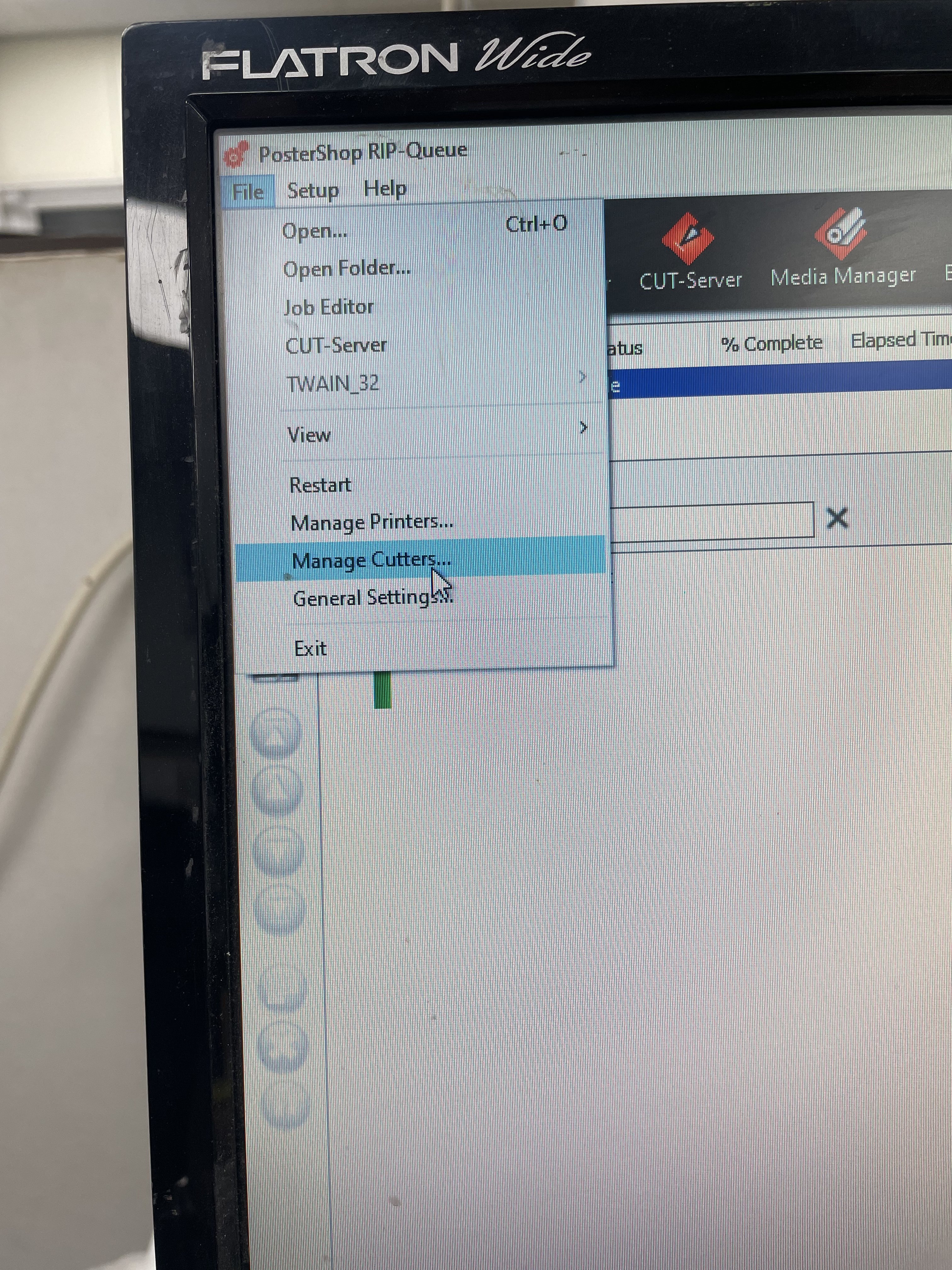

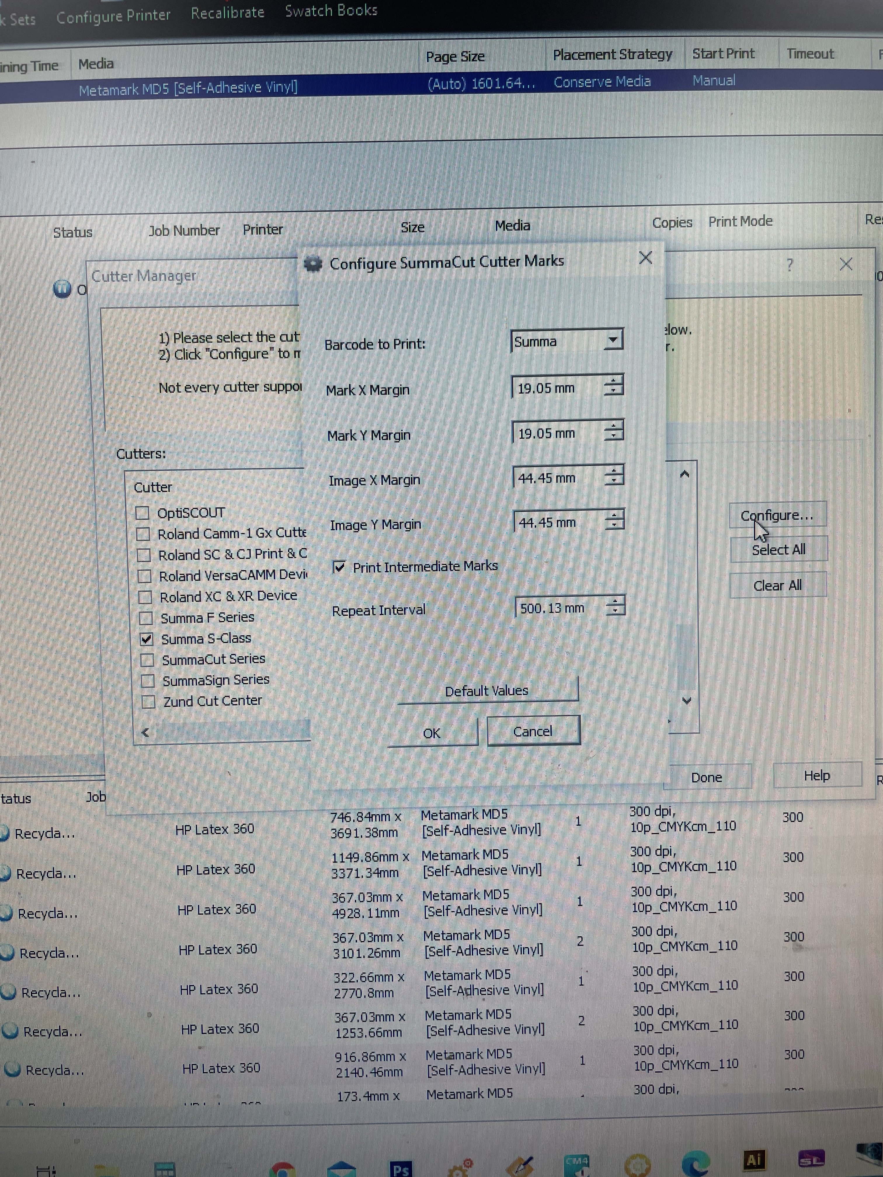

lennybennett
Frank you give me hope. I sat down all excited to do this change but failed to get the screens you have shown . I’m on onyx poster shop 12……. Any idea you or onyx? Thanks in advance (I really need this feature) summa s2t 160
