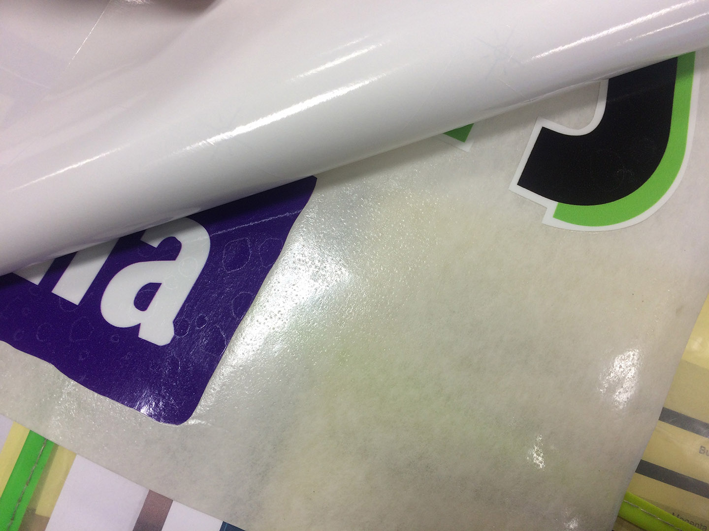

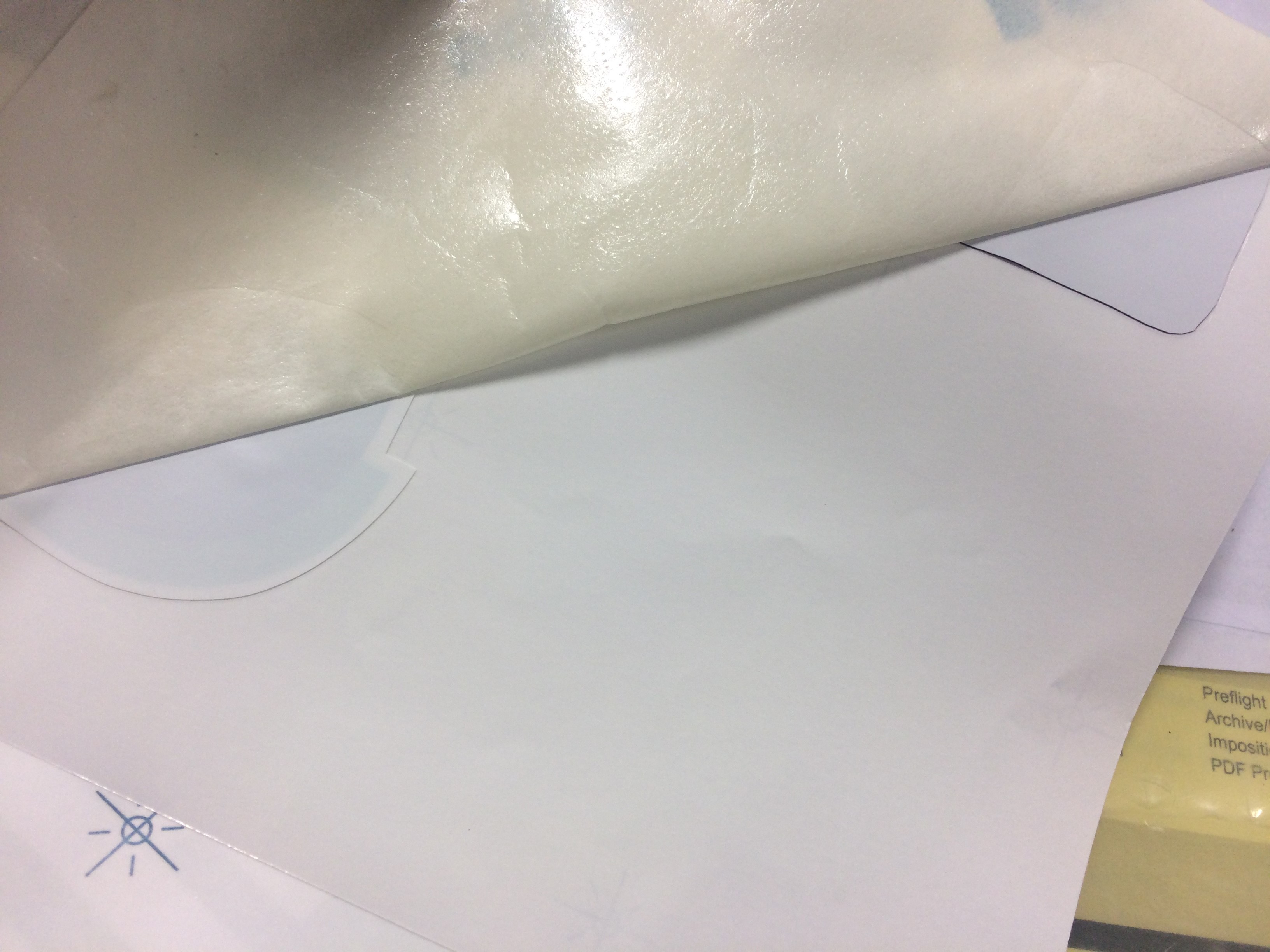

michsanford
We have one sample here, from another vendor of this customer. To me, it doesn't look like it has that second layer of vinyl on it.
michsanford
Here's a pic of a portion of the existing sample...
Dallas225
I would say Gasouthpaw is correct - clear vinyl reverse printed with an opaque white laminated to it then die cut
