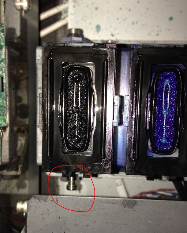

I have a vp-540 and noticed one of my orings was missing. It broke and fell below. I also noticed another one is pretty cracked up and ready to go. Do you know where i can get replacements or know what size this is so i can shop around an get 4 new ones.
Otherwise i will just remove one and go try and find one at the hardware store.

same thing happened to my vp540
seems cheap and silly but i just wrapped some vinyl in place of the oring,
it is still working after almost a year

We have them at www.solventinkjet.com. We have them for both 2 and 3 mm ink line. Rule of thumb, small dampers take 2mm and large dampers take 3mm, except for the JV3, which is 2mm
call if you have a question
800-328-1306

In these cases I use a small zip tie as a retainer... simply snip it off if you need to pull out the axle for whatever reason.
I see this at least once or twice a week.
