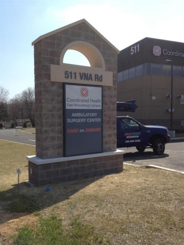

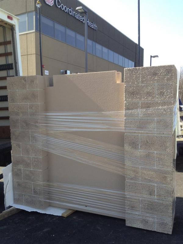

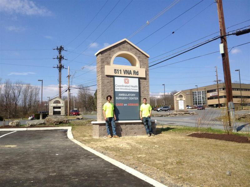

And our coolest in my opinion. I put this up almost 2 weeks ago and meant to post the pics but this month has been insane in a good way. let me know if you wanna see pics of the other jobs we have completed as of late

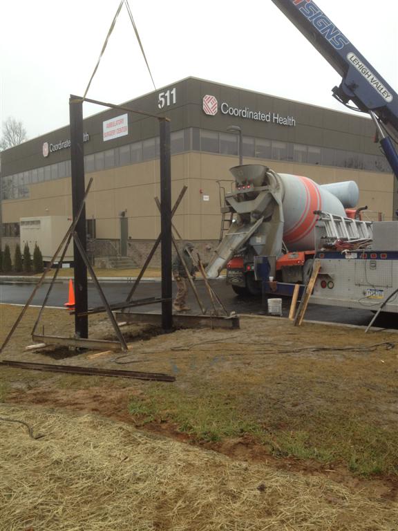

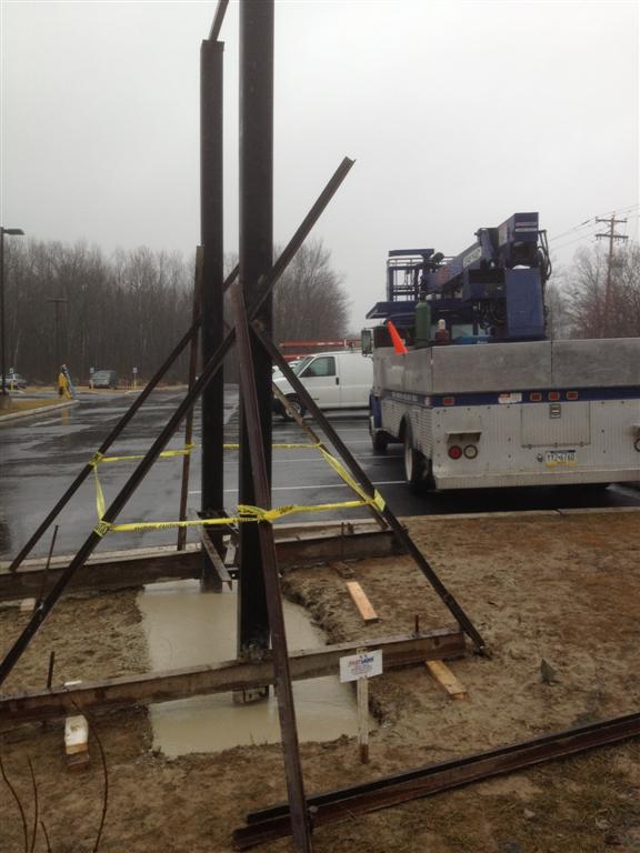

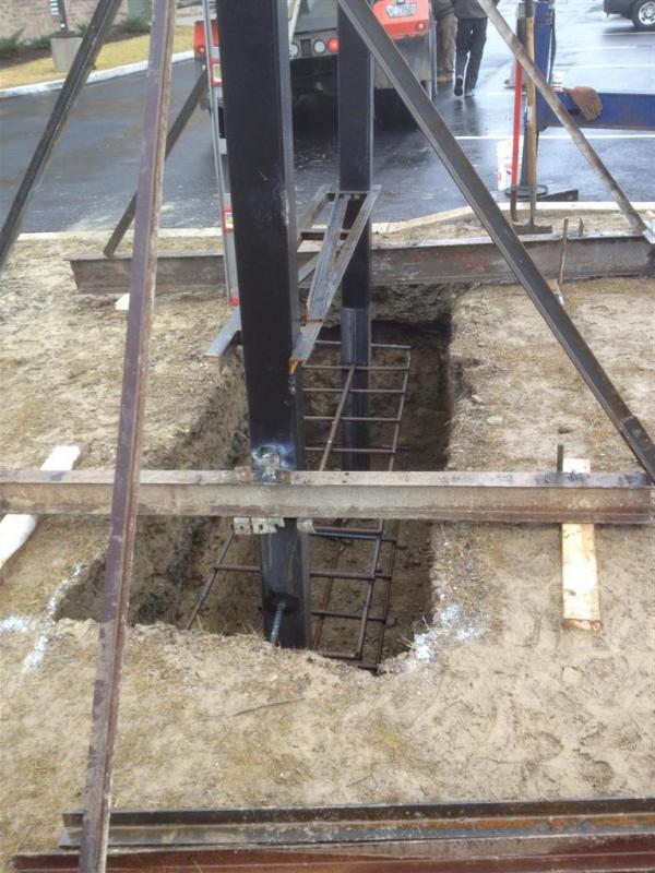

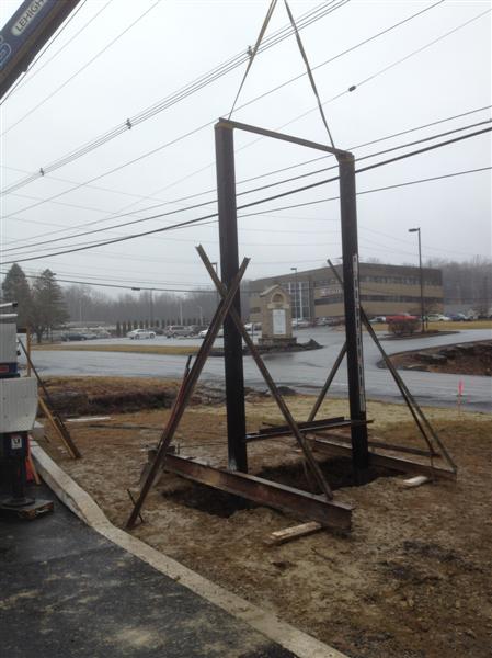

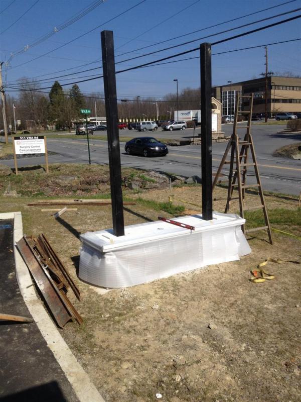

this is a 10x17.5' foam monument with two 8x4 single sided cabinets mounted to two steel 6x6 poles with internal alum cross bracing. the cabinets are bolted to the alum not hanging on the foam or plywood
address is just 1/2" flat cut acrylic
we dug a 3x10Lx5'deep hole for this, took 6yds of concrete on this freakin foam sign.
in the last pic with my bro and i standing in front you can see the split block monument across the street we were trying to match this one to

It looks good, but in the background of one of the pictures I see another 2 signs that are the same as this one.. Did you do them too?
:D Awesome!
Craig Sjoquist
Looks very nice, and good matching and total job.
Curious, can you create base in shop, dig hole, use crane to place base in hole, finish rest of install.
