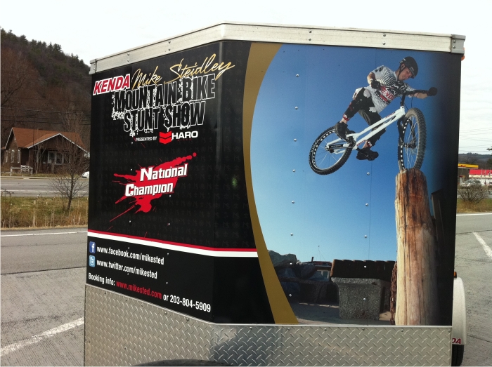

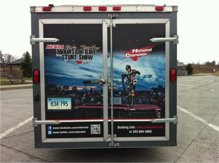

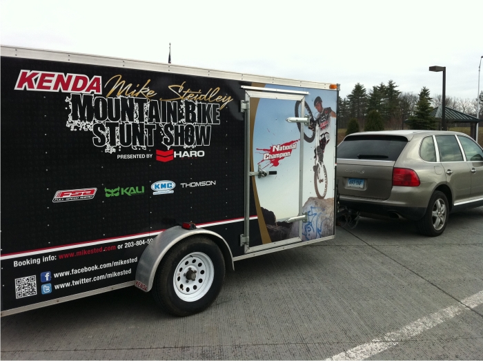

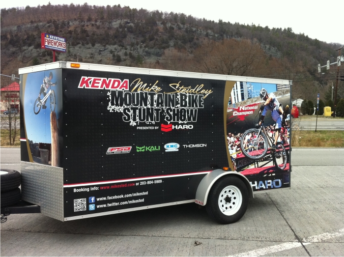

We did our first wrap this past weekend. It was a tight timeframe and the customer needed to leave for California before we finished it completely so we still need to wrap the area around the back doors and fix the phone number that runs into the fender:covereyes: when it comes back. Thanks to everyone who helped with answers to my many questions leading up to this. Also thanks to Jason and Todd at Allsquare for getting me the vinyl quickly and Steve at STS Motorsports for getting up early Saturday morning to laminate my prints!

There is a repeating pattern in the background above the red/white stripe but it's solid black below that line. We will print a rectangular panel that extends from the back corner of the trailer into the wheel area and overlay it. We haven't made the decision as to whether we'll a) move it to the rear and slightly shrink the size or b) make it 2 lines with the phone number under the website. It totally sucks that it happened but it was a rush job, the trailer was over an hour away, and I trusted someone else's measurements. I learned a LOT on this project and measure everything yourself is right up near the top of the list. *LOL*

everything else considered, you cut off the clients information in the wheel wells. i wont sugar coat it. a sh*t install would be better than decimating your clients info.
take it as a learning lesson. learn how to template. first try not bad. now you have something to build on.
dont listen to drunk mosh. learn how to wrap over the screws. its how its done.

Absolutely right, the clients info got covered, that's a no-no, and I'm willing to take my lumps for it. However I disagree that a sh*t install would be better. I'm not trying to dodge the fact that I screwed up....heck if I wanted to do that I wouldn't have included the picture of that side of the trailer.:smile: Even though it shouldn't have happened it is fixable, and in fact would have been fixed before it left the shop (and you guys saw pictures of it) if the customer hadn't cut 8 hours off of the time we scheduled to do the job. In a perfect world, considering it was our first wrap, I would like to have had twice as long to work on it because I knew I probably wouldn't get it 100% on the first try. Unfortunately we live in the real world.:cool:
And I'm not going to get into the "over or under the screws" argument today because I already had that post! *LOL* In this case I just didn't have the time to learn to go over them, nor the time to fix it if I tried and screwed up. Both options were discussed with the customer and he, ultimately, made the decision to go under the screws.
Stacy, I agree on the red. Customer wanted it and I should have known better. With the time frame it wasn't a battle worth fighting.
