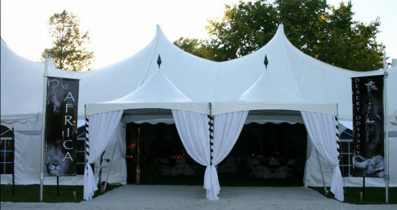

anyone ever seen/know these hardware shown in the jpg.
all i have to go on is the clients picture.

looks simple enough, from the image there appears to be no tension flex like a standard pole banner bracket.
so go to your hardware store get a "T" aluminum pipe fitting that will fit over the vertical pole and then thread tap the the "T" fittings for a secure fit, with a tension screw.
then get either a reducer or the same diam pipe for your banner pockets.
A MUCH EASIER method is to get a traditional pole banner bracket with metal straps and then you don't have to know the OD of the pole being used
