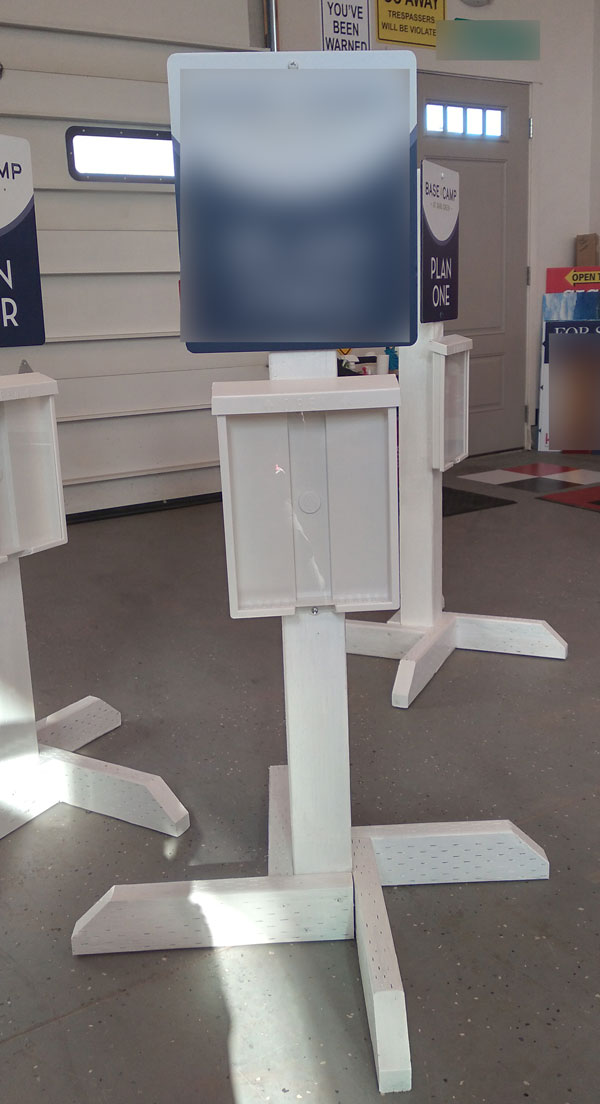

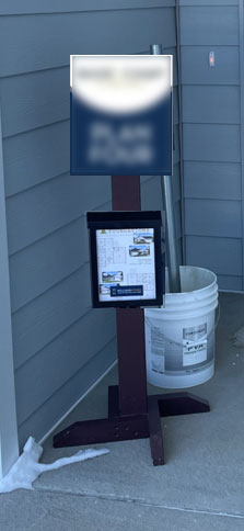

Have a request for some sign/literature stands similar to the attached example. Needs to be sturdy enough to stand outside in northern climate. Is there something out there I can order in? Tight deadline and I don't think I have time to make six of them within the timeframe. Thanks.

The base looks like it was built inhouse
That base is a 4x4 post with 2x4 legs, the long part of the build would be going and getting the material

The box with flyers in it looks like a realtor document holder, not sure if the top is just a sticker on a panel or a snap frame, but for the rush just slap some stickers on dibond and miter the top of the 4x4

Yes. I just quoted the job based on building it myself, all the stock stands I found online look dinky. I'll post some pics next week if I get the job.

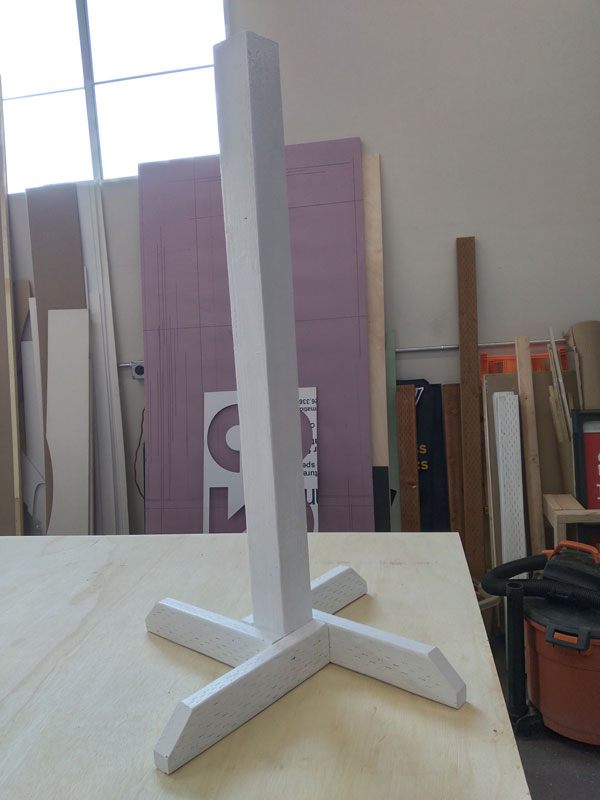

I got these done over the weekend. Not the most beautiful with such a tight deadline, but they'll work. I started out with the feet being 12" pieces and it seemed too top heavy or prone to get tipped, so they ended up at 16".
