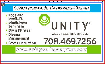

I'm having problems when I print out. every time I print a text with a blk outline shadow I have a blk or white box around my text any one have a solution??:banghead::banghead: using versawork rip program, roland xc-540 printer
m.hafenbrack
I trying to print out a text with a drop shadow but every time I send to print I get a wht box around my text that is not in the file.
