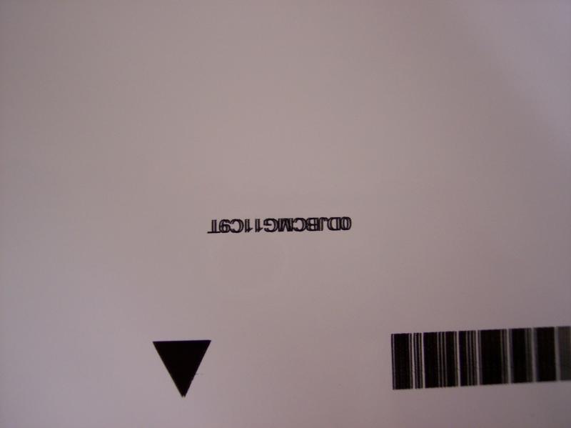

I am having a real problem with my Seiko Colorpainter 64S.
I know I have a problem with either my cyan or my light cyan head (severe overspray), and now I think I may have something wrong with the black. It is printing a double line on everything.

Here are a couple pictures that best illustrate what i'm dealing with. Thanks!

i'd say your bidirectional alignment is out of whack re: double black lines
That's what I thought too. I thought by working with the 4 adjustments that I did (head adj, i-pos, etc etc) that would be fixed. Maybe I am not making the right adjustments??

well, using jhill's idea about the bidirectional printing, i went ahead and printed them using the "outward" command rather than "bidirectional." It most DEFINITELY cleaned up my printing. I would still like to figure out how to get it bidirectionally aligned, but this will work for now! THANKS SO MUCH!

I had exactly the same problem with an HP900s (similar to yours)
The problem resided on the input voltage of the printer. When you change the PH voltage, all bidir. adjustments also change.
Also, an overspray (if you haven't change the ink type) means a low voltage on the printhead.
If your input voltage (you can test it from the outlet where your printer is connected) is low, or uneven, the printhead´s voltage changes accordingly; and you might think it's a misadjustment.
Do you have a good voltage regulator installed?
Connecting it to 220V (instead of 120V - check your manual first) should also work.
