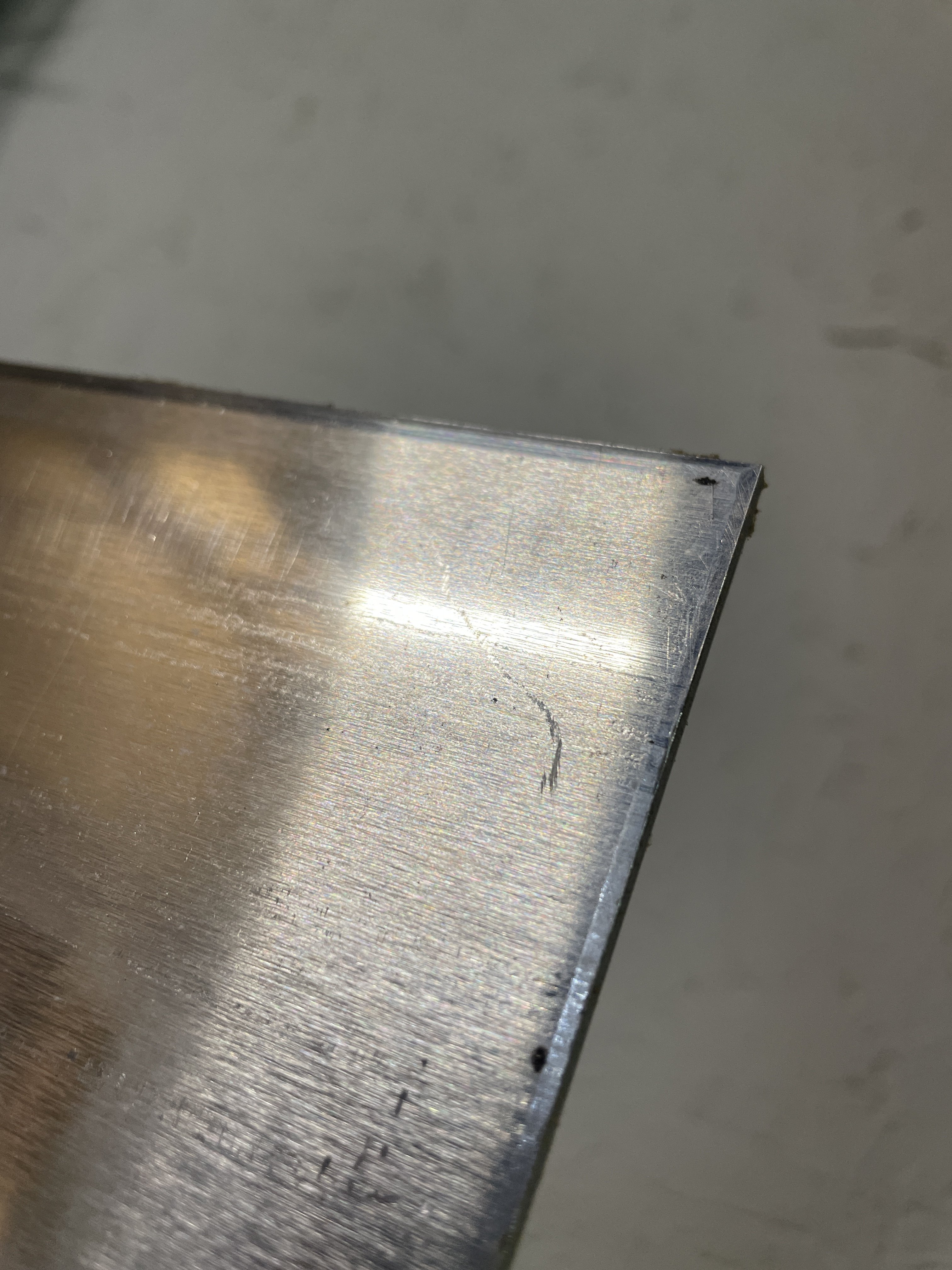

One thing I'm wondering, are you taking the mill edge off your sheets? To get the flattest panel out of a sheet of thicker metal, like .090", you have to take off the outer .5". Aside from the edges being dinged or marred in shipping, this area has a deformation from whatever monstorous contraption that rolls the stock flat. But surely you've been seaming smaller stuff that was definitely cut down well from that edge.

Yessir, if you get a fresh shiny sheet it, unpainted, lay it on a flat surface, and look across it, you can see a slight deformation toward the long sides. The short sides are sheared, and have their own different deformation, but this one is visible in the flat plane of the sheet.

On the edges of sheets, it's really smaller than I was imagining, though I know I've gotten some sheets that were worse than the one I got a picture of, this one is only about an 1/8" of 'non flat' area. This is a sheet of .125". The right hand side is sheared, the top is the milled edge, and you can see the difference in finish running along the top edge. It's pretty flat, but there is a definite deformation.

Thanks for the picture. I often have issues with my channel letter coil as well having an edge that has slitter issues. I'm probably the only one that notices if the burr is beyond spec for such things because I do trimless letters. Anyway. I was going to try Evercoat featherfill g2 primer to see if that works. I am doing a sign that is 14" x 4" with one seam.
