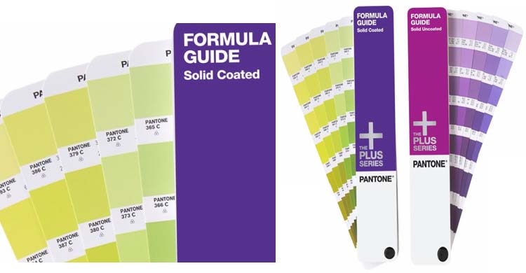

How many of you have a actual Pantone Formula Guide though? The ones issued by Pantone themselves. These are off course 100% true in colour, and should be used to verify that your printer actually prints the correct colours.
They also have cmyk conversion digits for each pms colour. Not cheap, but a pretty important tool when it comes to colour management.

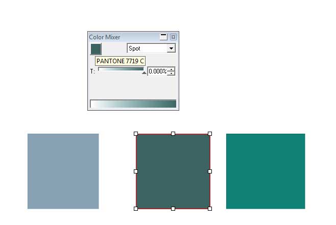

Um. If the spot colors are all correctly specified as they should be, in other words all colors are Pantones embedded in the pdf then there should be no color shift as long as your RIP recognizes Pantone spot colors.
When we open a pdf, ai, or eps that has vectors with Pantone spot colors assigned FlexiSign recognizes them correctly and prints them as it should.
I also just tested for the heck of it to be sure. Interstingly Flexi even honors and recognizes the new Plus colors that are not even part of Flexi's library. Attached.... the middle color is a new color from the Plus library.
I have the older libraries in a nice PDF format. I need to do the same and make a new one with the Plus libraries.
