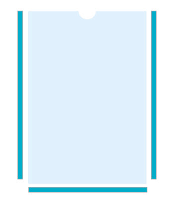

I am re-doing a "portable display system" for our school administrator to take with them to job fairs. (see below) The white boards are foam boards that I will apply vinyl to. One of the boards will show open positions printed out on an 11x17 sheet of paper. I'm looking for a way to attach it to the board without using tape. These will be used several times a year and will have to have the 11x17 paper taken off and replaced several times. They do not want to have to peel tape off every time and have it looking junky. I'm looking for ideas on how to do one of the boards for the 11x17 paper. Are there any suggestions out there? Thanks in advance, Darrin!

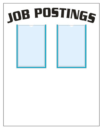

I would use some thin lexan or polycarbonate to make a document pocket that double sticks to the sign. Don't forget to make a thumb hole so they can get the paper out!
