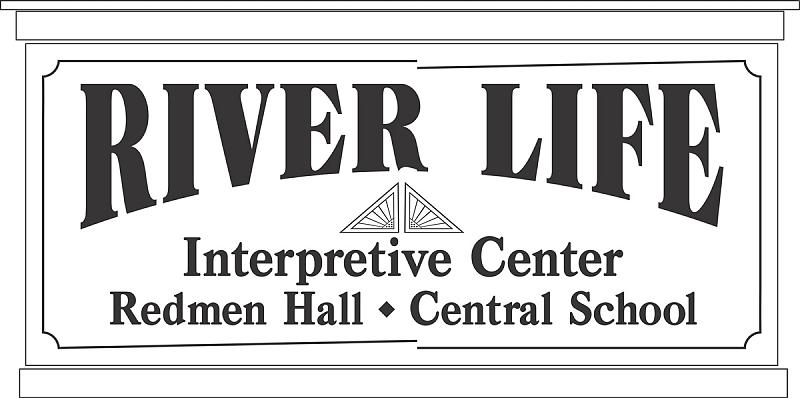

The attached file shows the resultant image when I open an .ai file that I've created in my drawing program. PhotoShop distorts some of the lines. It's random, too. It's only been doing this since yesterday, but it's driving me nuts.
Straight lines not connected. Sometimes straight lines go off on an angle.
Is it in my export filter from Omega 2.6? Or in Photoshop? I compose in Omega (.plt file) and export as Gerber .ai to my desktop, then open in PS.
Been doing it this way for years. No problems until now. What gives?

The things it is doing wrong are all items that are smart edit items. Try selecting them in Composer before you export them and copy/paste to a new page. This will destroy the smart edit. Then export as AI.

Nope, Fred that didn't work. I'm thinking now that it must have to do with my settings in Omega's export filter. I wonder what the proper settings should be? I was never schooled on this, but it hadn't been a problem.
The boxes that I have "ticked" are:
Use CMYK.
Export complex fills as complex fills.
Make cutter paths shapes.
Include fills for cutter path shapes.
Stroked.
Can you tell me if those are right?

If you're exporting to Photoshop, you might try using a raster format instead. I am making some assumptions here. If you're exporting from a vector application to a raster, I assume you want your final output to be a raster file for some sort of digital print application. If that's the case, you should probably forget about exporting in .ai format, and send it in a high resolution lossless raster file.
Have you tried exporting as a .tiff? That will give you a lossless compression format so you are less likely to have pixelation, but will preserve the lines as they are. They just won't be vector design elements.

The other thing I thought about this morning was the break in your lines in the thumbnail. It could be--just a guess here--that the break is where Omega has insterted some nodes in that particular line element. If you have node editing features (I'm less familiar with Omega than Fred) look at that section and see if there are nodes or points in the middle of that horizontal line. If so, delete them so you only have them in the corners, and try exporting in .ai again and see if that break doesn't disappear.
