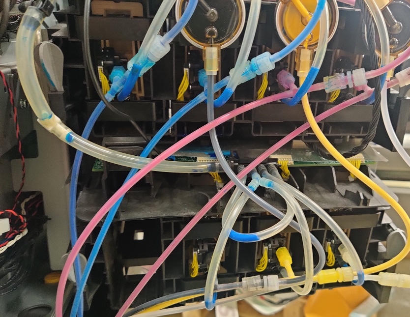

Recently callout to fit pip sensor on 360.
We have done this many times.
On this occassion the bag had broken.
we fitted the new sensor and cartridge, cleared broken bag error set the numbers up for the new pip.
It errored again. When we looked the air pipe going to the pip sensor had ink in it.
There was no apparent ink in the air pipes before we fitted. I can only assume the pip sensor was faulty.
Anybody had this before?
