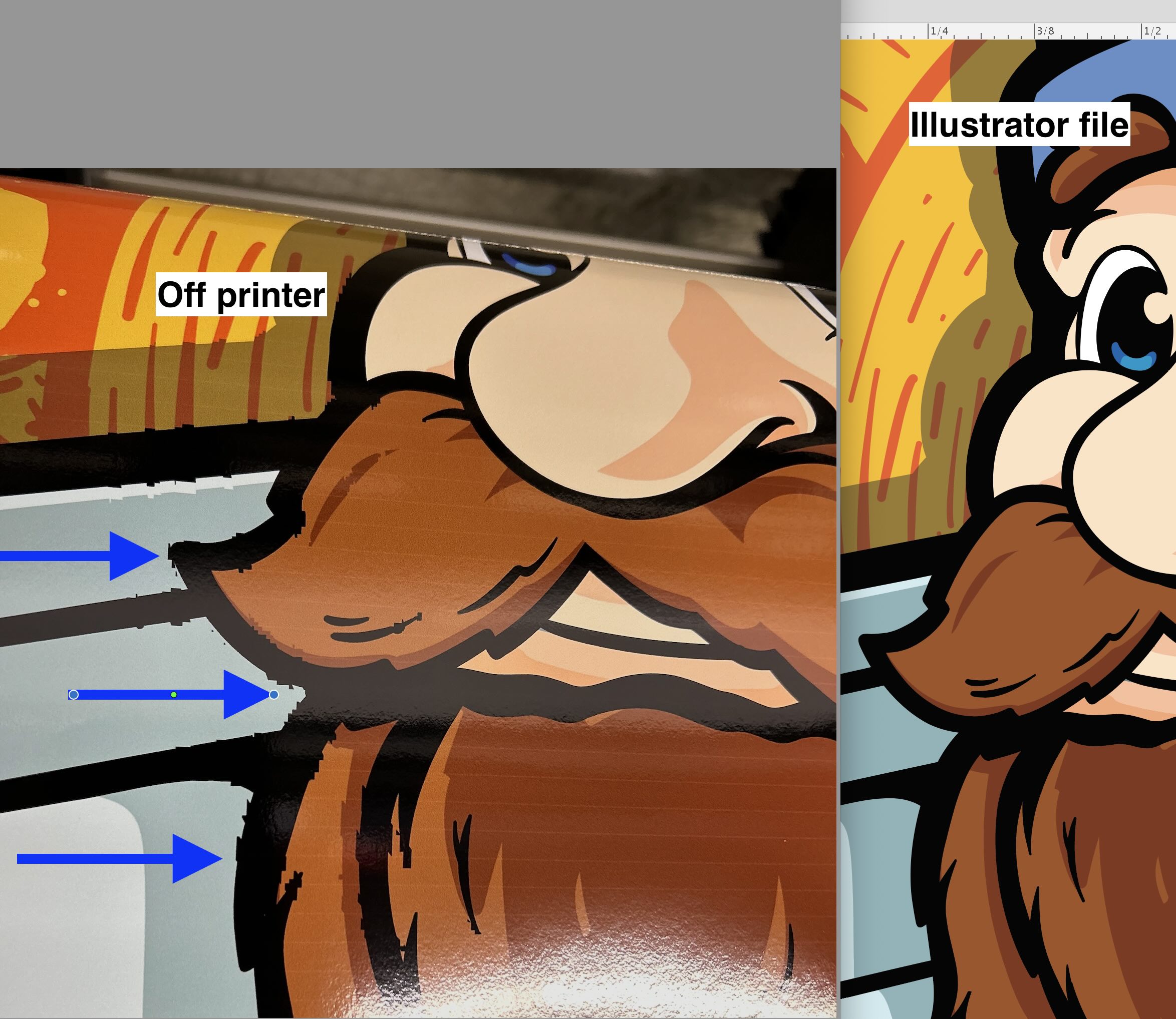

We save files out as EPS from Adobe Illustrator and then RIP the files in Onyx Thrive 21. We never have this issue when creating our own artwork (avoiding excessive clipping masks, stray points, transparencies, appearance styles, etc), but for whatever reason every now and again there is pixelation when printing another designers vector artwork. Sometimes even after rasterizing the artwork to a flat jpg this same issue will occur. Does anyone have any suggestions? (on attached photo the artwork to the left is the actual printed file while the artwork on the right is the adobe illustration vector file)

Signtologist
It's odd to me that the vector and it's drop shadow have artifacts in the same areas, but not the exact same. If I were trying to determine the issue, I'd start by getting rid of that layer.
Also you've got some gnarly banding there...
