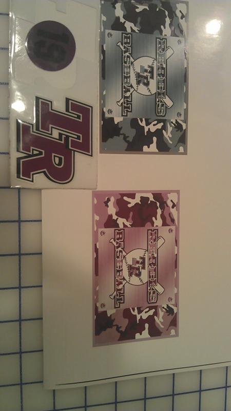

Ok, so i have a banner that i need to print this weekend for a family members baseball team. They gave me a helmet sticker so i could get close to the color (maroon). I made the banner exactly how they wanted it so dont beat me up on the design, afterall the customer is always right, right? anyway, i can not, for the life of me, get the freakin thing to print the colors right. the Maroon prints ok but then all the greys and the brushed aluminum tile from aruora graphics have a pink tint to them. I tried turning color correction off just to see what would happen and the greys print fine but the maroon prints blackish brown. I have re dont the artwork several times in RGB but can not get the result i need. Im new to the digital printing and would love to get some advice, Im tired of wasting time and material trying to get it to print right. Thanks in advance. Oh yeah, designing in corel and flexi and i realize doing test prints on vinyl will have a different result than on gloss banner material, im just trying to get it close.

Ok well welcome to the world of printing.
Seriously if you are using canned profiles(ones you downloaded) then you are going to have these kinds of problems.
Without a lot of mods to your rip and building your own profiles you will almost always have a problem with black and grey.
Most people will tell you that your blacks and greys will have a slight pink or green hue to them. I had this same issue for a long time once i really got into color matching and building my own profiles i now can print perfect greys and black blacks and I can hit almost every pantone color as well. This was no easy task and I am affraid you are not going to get to my print level by the end of the weekend.
However here is some good news since your greys are pink we know that your magenta is the problem so you need to find in your rip how and where to do a linerization.
When you do the linearization you will need to turn down the magenta this will help fix your grey problem BUT it will probably cause your maroon to print wrong.
So you really need to do the linearization and adjust all the colors to the best of your abilitie. Without the right equipment this will never be right but you may be able to COMPENSATE things to get it close.
I just checked your profile and see that you are running Flexi 10 Pro I dont use flexi but have in the past and Flexi will allow you to adjust everything and build your own profiles but you will need a photospectrometer to do it.
When you do the linerization you need to look at the cmyk chart and adjust to the number where it is full but not bleeding or saturated. this will get you close I will tell you this on my JV33 I had to turn C down to 65 M down to 60 and the Y to 60 and the K (black) down to 55.
These numbers were for my machine and were found with photospectrometer. So if you have to adjust them down alot its not uncommon but as i have stated with out the right equipment it will be perhaps better but never great.
Good Luck to you.
Oh I almost forgot since you dont have the equipment you may waste 10 feet or more trying to get it right. So load some cheap stuff or buy yourself an i1 and send me a PM I will be more than happy to help you build a great profile.

It's not that difficult.
First, what elements are vector and which are bitmaps? I assume the tacky but inexplicably popular metallic fill is a bitmap but what about the rest of the elements?
In spite of the protests of the strident profile neurotics shoveling on this sand pile, you only need one or two profiles for virtually everything. I've been printing for some years now and my entire process is pretty much what you see is what you get without obsessively calibrated monitors and an entire library of profiles. Just soft-proofing, one or two profiles for everything [one of the two I have I never think to use], and understanding my equipment. I'll match my product against anyone's.

The logo and the camo are vectored so I could change the colors to what I needed, the brushed aluminum and the screws are jpeg
Review your rendering intents and try setting them to 'No Color Correction' or, failing that 'Saturation', for everything except bitmaps. Set the rendering intent for bitmaps to 'Perceptual'.
This did it, thank you so so much. Ill post some pics after I get caught up on some stuff. Everyone kept telling me just print it and say sorry, well im not like that, i would rather lose my @$$ on a job and learn something from it than just give up and move on just to run into the same problem another time. I appreciate everyones input!:thankyou:
